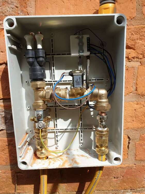

temp power connection i need to run the ring to it and put a switched fcu on it but at least its earthed...
I will replace the left hose that goes up the garden with mdpe when i dig it in. ALso now have the nr valve on the incoming and will keep it on a hose so i can disconnect and drain in the cold
