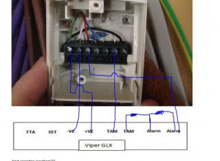

Just took the colours as granted.
No worries. To be fair, Alpha Alarms up here used to use the green as pos and the white as neg for some odd reason. Still catches me out on occasion when swapping out a detector!
i use red/black for power, but i've seen green white done quit allot, think its a colour consistency preference. i.e. days if 4 core (obviously no G/W) for contacts, 6 core for detectors, so you could maintain the more common 4 core red/black for zone feed out, yellow blue for the zone return on DP systems.
today eol means you can feed 3 detectors from an 8 core, commonly brown/orange would be to the furthest device or pab, but maintain green white as power.
before anyone shouts and hollers, and gets all snotty, its what i have seen - not what i do.
Yes I have had this a couple of times, I really fail to see how Green is a positive colour.
For the record Red, White, Yellow and Orange are positive colours.
As for using green and white for voltage in the first place, IMO it's wrong.
