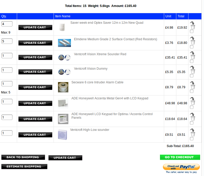

SoupDragon Posted September 9, 2012 Author Share Posted September 9, 2012 Stick with the gen 4 mate So, this is the equipment I'm looking at I'm unsure about batteries, brands ect. Not sure what internal sounders you guys use so I just went with the same brand as the SAB. Does this system (the Accenta) technically conform to grade 2x? The Texecom PE24 would be my other option and I've looked at the Castle Care-Tech Euro Mini which has that weird "modern" keypad. Don't know what to make of the Texecom Veritas r8+. Link to comment https://www.thesecurityinstaller.co.uk/community/topic/33381-advice-on-sensor-positions/page/4/#findComment-289821 Share on other sites More sharing options...
james.wilson Posted September 9, 2012 Share Posted September 9, 2012 No the accenta is not graded, if you want graded use a euro mini securitywarehouse Security Supplies from Security Warehouse Trade Members please contact us for your TSI vetted trade discount. Link to comment https://www.thesecurityinstaller.co.uk/community/topic/33381-advice-on-sensor-positions/page/4/#findComment-289822 Share on other sites More sharing options...
MrHappy Posted September 9, 2012 Share Posted September 9, 2012 are those contacts going to work with the controls ? Mr Veritas God Link to comment https://www.thesecurityinstaller.co.uk/community/topic/33381-advice-on-sensor-positions/page/4/#findComment-289823 Share on other sites More sharing options...
james.wilson Posted September 9, 2012 Share Posted September 9, 2012 Also use a 16 ohm speaker instead of an internal sounder securitywarehouse Security Supplies from Security Warehouse Trade Members please contact us for your TSI vetted trade discount. Link to comment https://www.thesecurityinstaller.co.uk/community/topic/33381-advice-on-sensor-positions/page/4/#findComment-289824 Share on other sites More sharing options...
SoupDragon Posted September 9, 2012 Author Share Posted September 9, 2012 are those contacts going to work with the controls ? I can't see why they wouldn't Also use a 16 ohm speaker instead of an internal sounder Like this? http://www.securitywarehouse.co.uk/catalog/index.php?main_page=product_info&products_id=394 Link to comment https://www.thesecurityinstaller.co.uk/community/topic/33381-advice-on-sensor-positions/page/4/#findComment-289825 Share on other sites More sharing options...
Lwillis Posted September 9, 2012 Share Posted September 9, 2012 Yea one of those http://www.securitywarehouse.co.uk/catalog/index.php?main_page=product_info&products_id=395 Prefer them ones myself but it's personal taste . Have you decided on a panel yet ? Link to comment https://www.thesecurityinstaller.co.uk/community/topic/33381-advice-on-sensor-positions/page/4/#findComment-289826 Share on other sites More sharing options...
sixwheeledbeast Posted September 9, 2012 Share Posted September 9, 2012 Mach 1's don't have a lid screw, for the extra look at the nicer looking Soint 1. Yuasa batteries are recommended. I am sure them contacts (Red Resistors) do DP and also 4K7/2K2 which is Menvier/Texe stuff. Link to comment https://www.thesecurityinstaller.co.uk/community/topic/33381-advice-on-sensor-positions/page/4/#findComment-289827 Share on other sites More sharing options...
