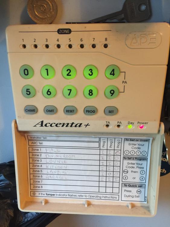

September 13, 201610 yr comment_450094 what lights are on the panel, can you upload a pic? securitywarehouse Security Supplies from Security Warehouse Trade Members please contact us for your TSI vetted trade discount. Link to comment https://www.thesecurityinstaller.co.uk/community/topic/40431-un-used-optima-g3-blue-strobe-light-constantly-flashing/#findComment-450094 Share on other sites Share on LinkedIn Share on X Share on Facebook {lang="reddit_text" Share via email Share on Pinterest More sharing options... Share this post
September 13, 201610 yr Author comment_450095 Here you go. Thanks for replies so far. Link to comment https://www.thesecurityinstaller.co.uk/community/topic/40431-un-used-optima-g3-blue-strobe-light-constantly-flashing/#findComment-450095 Share on other sites Share on LinkedIn Share on X Share on Facebook {lang="reddit_text" Share via email Share on Pinterest More sharing options... Share this post
September 13, 201610 yr comment_450096 you may have a faulty bell then. Need to find out if the panel is driving it with a meter securitywarehouse Security Supplies from Security Warehouse Trade Members please contact us for your TSI vetted trade discount. Link to comment https://www.thesecurityinstaller.co.uk/community/topic/40431-un-used-optima-g3-blue-strobe-light-constantly-flashing/#findComment-450096 Share on other sites Share on LinkedIn Share on X Share on Facebook {lang="reddit_text" Share via email Share on Pinterest More sharing options... Share this post
