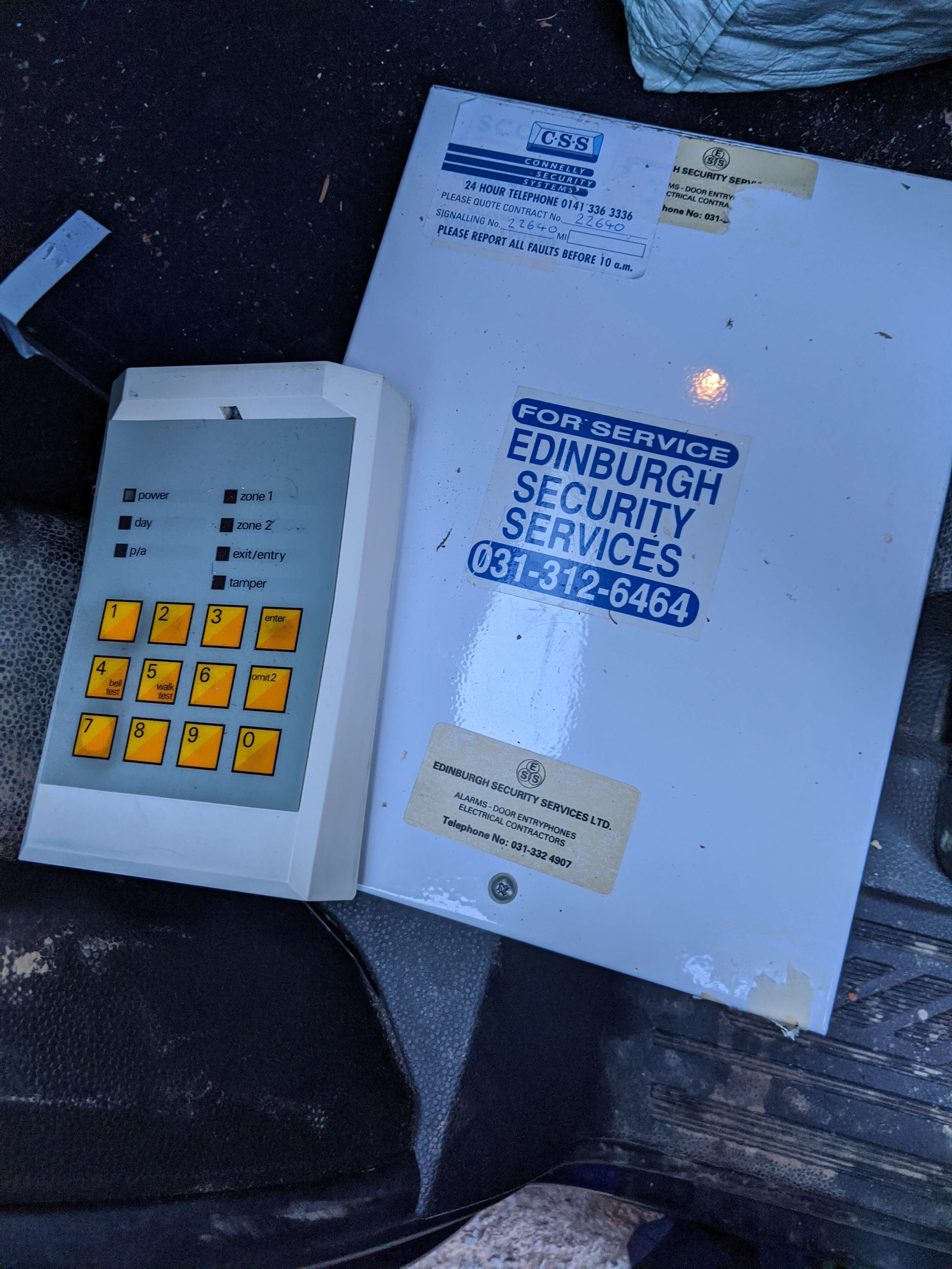

  3. Some more junk if you want it? The first 2 boxes are decoys. Dunno if you collect them? There is a keypad inside the gardtec panel - not sure if it works? The old Scanny apparently still works and was regularly maintained. Grant

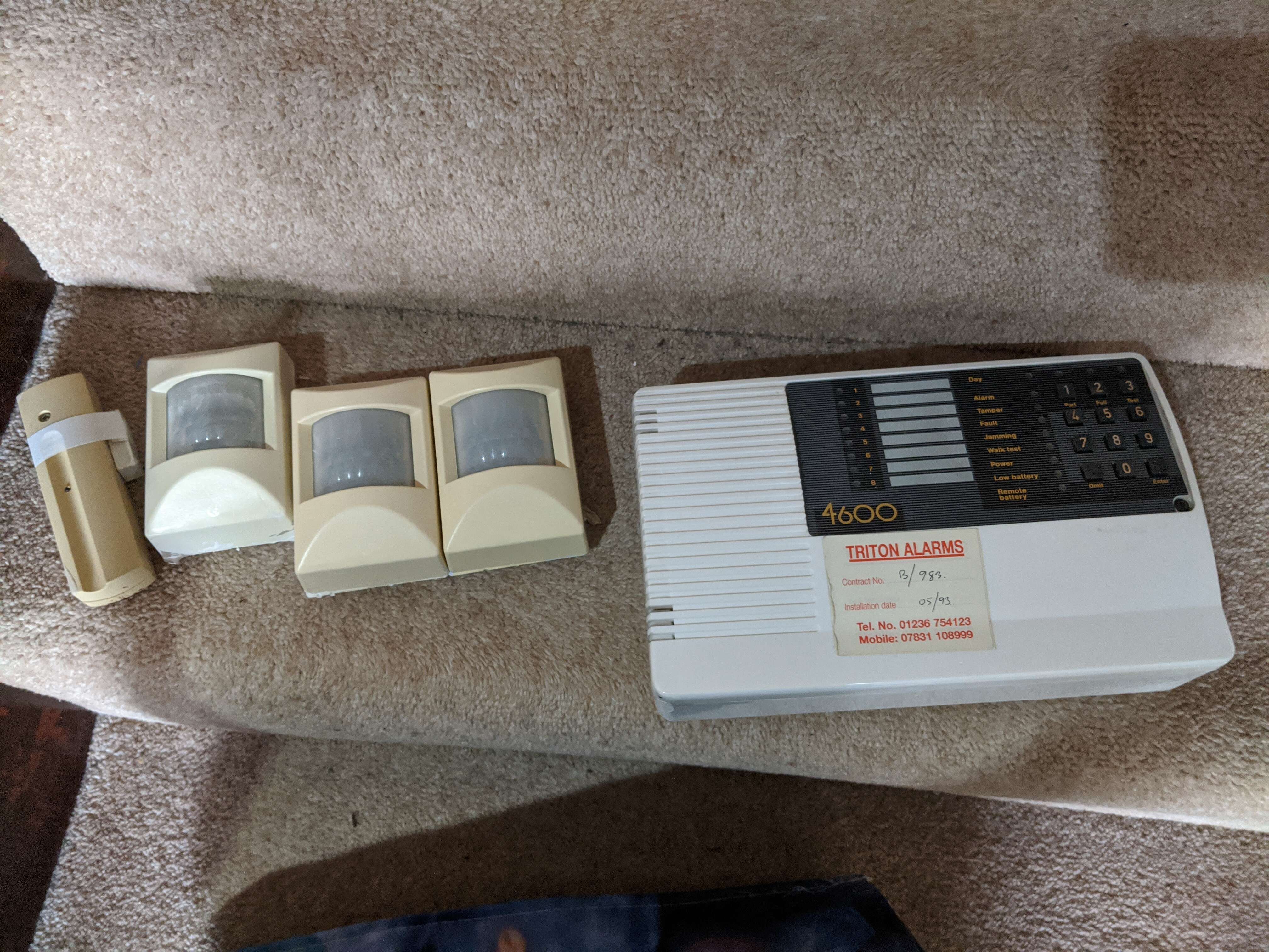

  6. This too if you want it?
