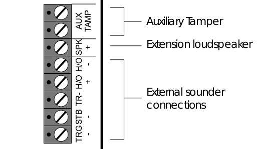

AUX TAMPER TEXECOM ALERT Sudenly after a few days after the install texecom odyssey 3
I still think it's the G3 part that has the fault from what you have explained so far, so wiring bell as G2 like I already said would stop the fault. The other option is getting someone in that knows what they're doing.
If it's "Aux fault" and not "bell tamper" then I don't think it would be the bell tamper? I recall EN was minimum 2" fixings for warning devices but I don't remember if it was overall screw length or penetration. It is daft to have 2" screw and more than half of it not in the wall. I don't like these for this either but it apparently makes them easier to be lazy measuring up for drilling.
The wiring is poorly terminated but it doesn't look loose... There are no resistors required for compatible panels/inputs. You shouldn't mix G3 Aux Fault and Aux Tampers together, but it doesn't seem to have been wired it like that anyway. You haven't terminated the test terminal at the panel from what I see, so it's not doing the G3 periodic testing which I expected to be part of the issue. I'd say it's DIY so just follow the instructions for Grade 2 installation using 5 wires. Make sure the bell hold off and battery works see if the fault clears.
So you have it wired as a Grade 3 bellbox and it's maybe failed one of the G3 self tests I'd guess? Assuming you have everything wired and programmed correctly on a Premier panel that is.
