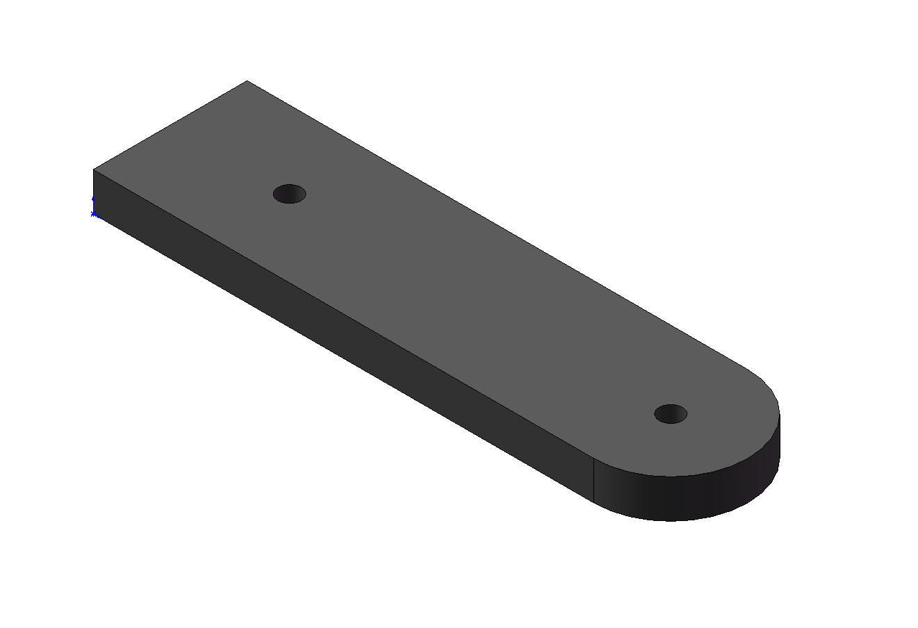

KP do plaggy spacers to lift G3's of metal surfaces, I wonder in 5mm of plaggy would help prolong the life of RSC which oftend sit in the wet ?
We use them on most RSC's now, seem to have much less trouble.
Edited by alterEGO
Many, many years ago I had a friend who worked for a company called Magnetic Shields.
He used to give me 'off cuts' of one of their magnetic shields, they were like pieces of soft black cardboard about 4 or 5mm thick.
I used to cut it to fit the size/shape of the magnet to be fitted and used that as the spacer, absolutely no problems, even the heaviest magnet would not 'stick' to the most solid metal door.
Wish I still had access to this.
Someone told me I was ignorant and apathetic, I don't know what that means, nor do I care.
I don't quite follow you?
I'm saying one of these bunged under the contact
yep, thems the ones, come in 10s.
