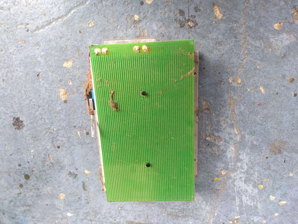

MrHappy Posted September 2, 2019 Share Posted September 2, 2019 (edited) 57 minutes ago, Jack b said: Does anyone know how an anti drill tamper works and how i could make one myself? A bell with plastic lid can a have pcb with track which forms a 24hr circuit like cc wiring A metal bell can a have circuit made between inner & outer cover which is completed by the drill bit Edited September 2, 2019 by MrHappy 1 Mr Veritas God Link to comment https://www.thesecurityinstaller.co.uk/community/topic/43090-anti-drill-tamper/#findComment-488272 Share on other sites More sharing options...

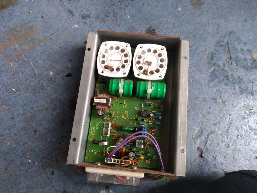

timeserved Posted September 3, 2019 Share Posted September 3, 2019 These use to be popular in the 90's for those of us who remember the good old expanding foam attacks. Link to comment https://www.thesecurityinstaller.co.uk/community/topic/43090-anti-drill-tamper/#findComment-488300 Share on other sites More sharing options...

Jack b Posted September 3, 2019 Author Share Posted September 3, 2019 11 hours ago, james.wilson said: Yes So i large circuit board or something with wires that go into the tamper terminals? Link to comment https://www.thesecurityinstaller.co.uk/community/topic/43090-anti-drill-tamper/#findComment-488326 Share on other sites More sharing options...
