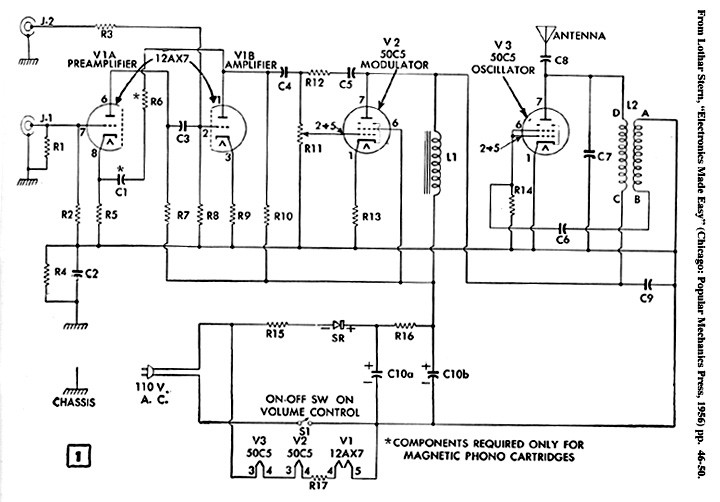

Been done before, though tricky. Below is a simplified version of the more popular interface sold by Bentley, suitable for home production;
Thank you for your reply. I don't follow the attached pic, not sure we're on about the same thing!?
Ah, you can't beat one of those good old fashioned tube valve interfaces...
