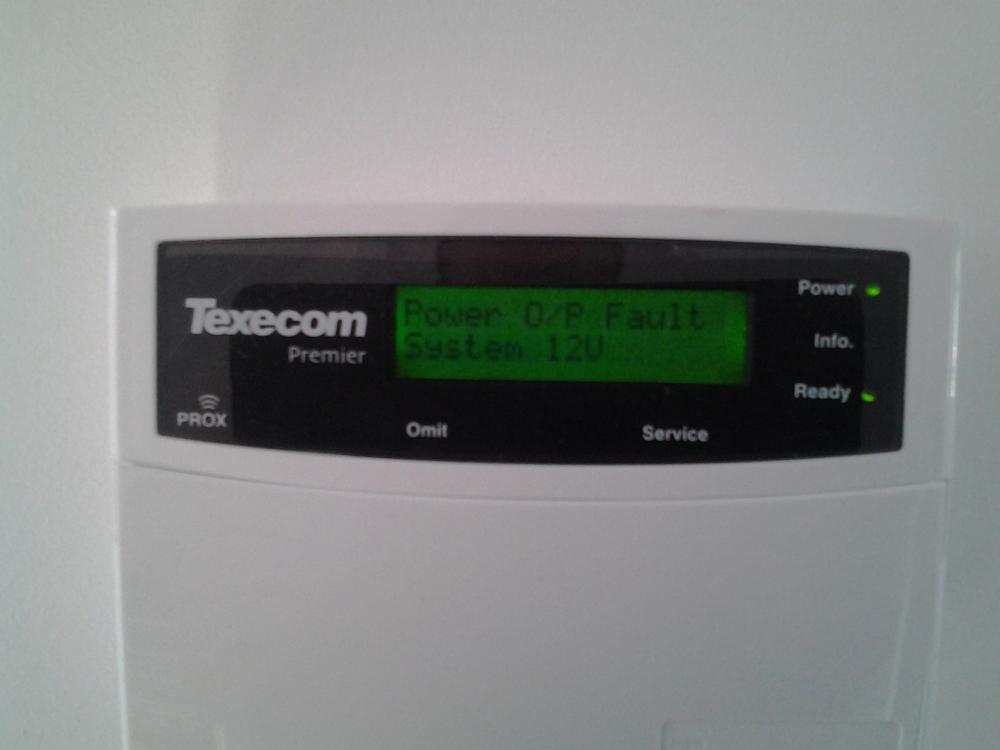

I have a texecom elite 24 poly installed last week so new unit.. sparky onsite turned off power and forgot to turn it on.... we had O/P fault showing.. turns out the sensor on the Psu has gone faulty.. we checked all incoming voltage from the 230v supply and the 12v into the panel.. all good.. we contacted texecom who confirmed the Psu had a faulty sensor chip.... £x for new Psu..

This PSU issue has been on and off since they released the panel with it how many years ago, not convinced its robust enough or the QC from whoever supplies it isn't good enough (I am guessing its not made by Texecom)?
as said previously a reset is all that should be required unless faulty
whats interesting is the mains off clears on its own when its restored, leaving the 12V fault, why don't they both clear when restored?
