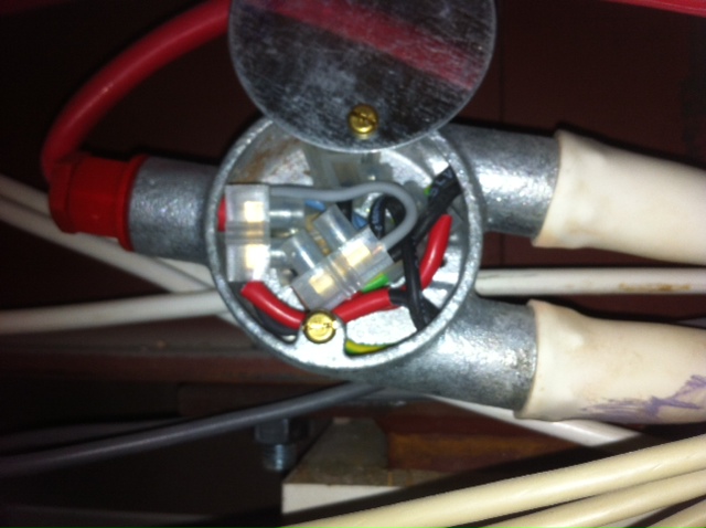

matthew.brough Posted April 3, 2013 Author Share Posted April 3, 2013 Todays investigations haven't helped me sleeping well at night . . . www.securitywarehouse.co.uk/catalog/ Link to comment https://www.thesecurityinstaller.co.uk/community/topic/34300-nice-loop-on-this-install-by-a-bafe-firm/page/4/#findComment-311599 Share on other sites More sharing options...
MrHappy Posted April 3, 2013 Share Posted April 3, 2013 appears to be a master class in how not to junction FP, Mr Veritas God Link to comment https://www.thesecurityinstaller.co.uk/community/topic/34300-nice-loop-on-this-install-by-a-bafe-firm/page/4/#findComment-311600 Share on other sites More sharing options...
Paul. Giles Posted April 3, 2013 Share Posted April 3, 2013 Now i know why wholesalers look at me blank when i ask for porcelain connectors. Seems no fooker uses them! Dont know how far you go with this especially being fire? Best put lids back on and get the inspectorates in? Although i dont see an issue with no glands fitted to certain entry points? We have done this many times especially when coming out of trunking to the device. Link to comment https://www.thesecurityinstaller.co.uk/community/topic/34300-nice-loop-on-this-install-by-a-bafe-firm/page/4/#findComment-311601 Share on other sites More sharing options...
jb-eye Posted April 3, 2013 Share Posted April 3, 2013 Pic 5,6 &7 are the same pic. Cant see anything wrong with pic 9 & 11. We used to interweave sounders 20 years ago. Its blatently a poor practice, 4 core is pretty much for class change and the likes these days. Customers! Link to comment https://www.thesecurityinstaller.co.uk/community/topic/34300-nice-loop-on-this-install-by-a-bafe-firm/page/4/#findComment-311608 Share on other sites More sharing options...
