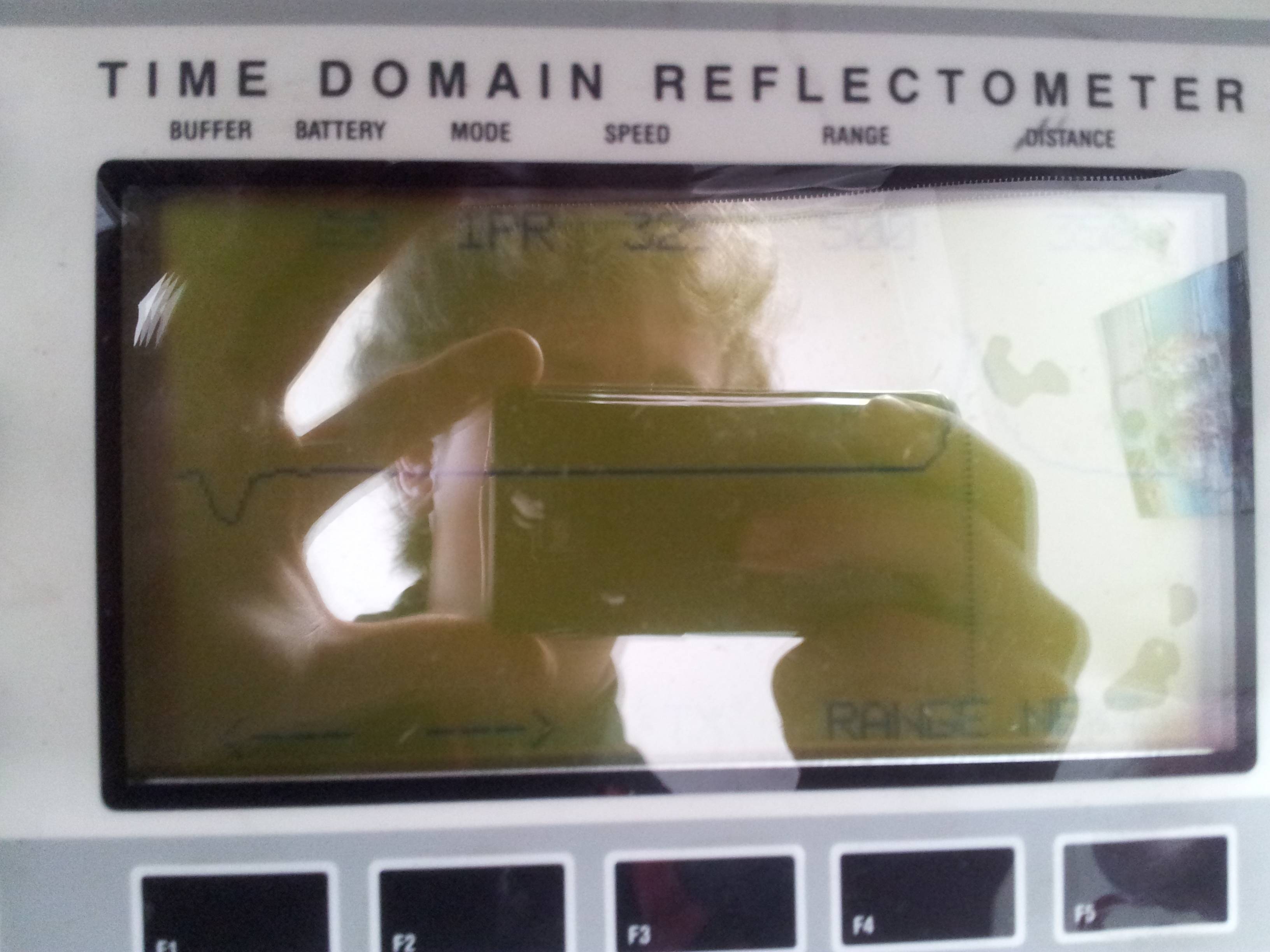

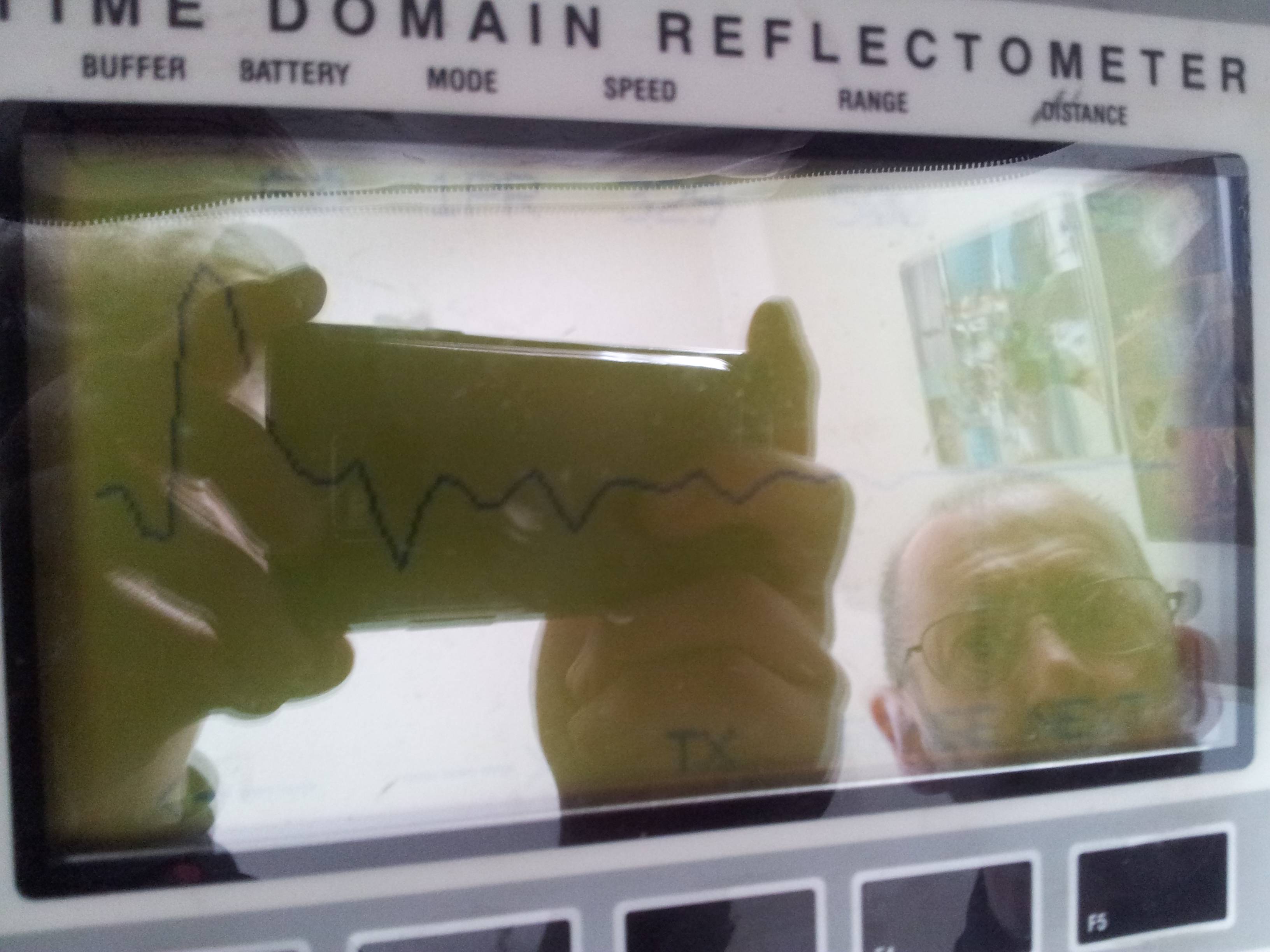

skywalker Posted April 4, 2015 Share Posted April 4, 2015 be careful with staples!we recently had an intermittent fault with an IP camera which had about 10m of its run stapled. we took a reflexomiter, and this is what the cable looked like! you can see where the staples were... (and where the installer had obviously ragged a kink through the wall)and this is what the new cable run looked like, secured with clips!Generally i'm a fan of staples, but they can cause problems down the line, even when everything looks fine! Link to comment https://www.thesecurityinstaller.co.uk/community/topic/31816-use-staples/page/8/#findComment-415038 Share on other sites More sharing options...
