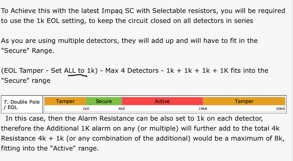

sparks75 Posted October 9, 2020 Author Share Posted October 9, 2020 I had a reply form another forum which resolved my problem without having to change the sensors. I have attached a picture in the hope it might help someone else out. This configuration will not adhere to a graded alarm Quote Link to comment Share on other sites More sharing options...
sixwheeledbeast Posted October 9, 2020 Share Posted October 9, 2020 Never mind graded, I wouldn't recommend it at all! These thresholds are there to reduce false alarms not to abuse with more devices. Also if that theory is correct you will have to use strictly 4 devices, as 1 or 2 devices certainly wouldn't go Active when required. Add to that' no tamper or fault detection on anything beyond the first device and it's not an option that's fit for purpose. Quote Link to comment Share on other sites More sharing options...
MrHappy Posted October 9, 2020 Share Posted October 9, 2020 eh ? 4 x sensor will read 4k normal when 1 is alarm it will read 5k when all are in alarm 8k bodgey Quote Mr Veritas God Link to comment Share on other sites More sharing options...
