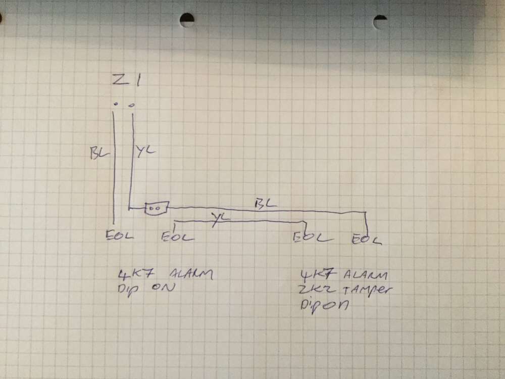

First post so hoping you can help out. I’m swapping out an old Honeywell alarm with an elite 24. The alarm has 9 shock sensors among other sensors. The shocks have been daisy chain wired in a group of 5 and a group of 4 using 6 core cable. My intention is to spilt the 5 into a group off 3 on one zone and 2 on the other and likewise for the group of 4. I have taken blue out of the zone terminal and connected to EOL carried the yellow through to the 2nd sensor and connected to EOL and then linked the remaining 2 EOL terminals See diagram. I have selected 4k7 on the first impaq for Alarm and 4K7 Alarm and 2K2 tamper on the second impaq with this configuration the zone shows tamper? I have the zone programmed in wintex as EOL. Any ideas or i am I missing something? TIA
It's really not ideal to have multiple devices on one zone you have no idea which has triggered. Do you have a latch line or some way to identify the triggered device?
If required the maximum EOL devices supported on one zone is 3 and you would wire only shunt resistors (4k7) in intermediate devices and usual shunt and EOL in the last.
With devices that have built in resistors not all of them support this type of unusual multi device setup either so you'd have to work around this.
Thanks. Yes agreed about more than one device buts its has been wired that way and running more cables is not an option although most of the devices are 2 on one large window so at least the zone can be pinpointed and isolated if necessary without affecting other rooms.. That s my fear that the texecom impaqs d not support this configuration and i cant seem  to find anything online. Also looking at the wiring for the imapq it doesn't look like you can wire them as NC so I'm a bit stuck on a way round this. Any ideas? Thanks

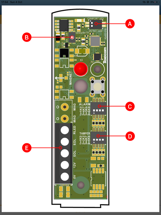

If there is no double pole type connections and no option to wire them with others then I don't see how it's possible without doing stuff to the PCB.
Not fitted the new impaqs but the old version had two versions the more expensive had more terminals and latch line options.
Thanks for your replies so far. I thought it was me missing something but looks like it could be a problem. Probably should check before buying! I will ring texecom tomorrow and let you know if there is a solution . FYI @sixwheeledbeastPicture attached of the new impaq terminal layout,.
