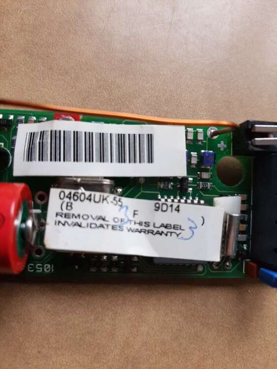

Johnc Posted April 22, 2020 Share Posted April 22, 2020 I am looking to buy the board for wireless contact scantronics part 04604uk-55 9d14 They are quite old units. Does anyone have one of these working? I am happy to purchase complete unit as long as it is working Or does anyone know anywhere I can purchase it. They were made around 1999 Many thanks trying to avoid having to replace complete system due to one faulty board. Link to comment https://www.thesecurityinstaller.co.uk/community/topic/43733-scantronic-4600-door-contacts-not-functioning/ Share on other sites More sharing options...

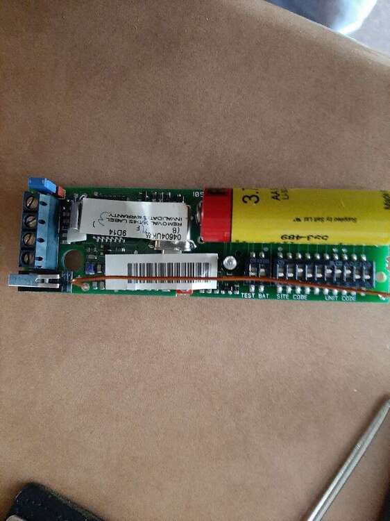

Johnc Posted April 23, 2020 Author Share Posted April 23, 2020 Yes I have soldered new battery 3 days ago and tested it by switching battery dip on. Unit transmits tamper alarms to 4600 control box, when you move it,but when situated next to a contact it does not activate. Red led does not light up when opening or closing a door. The fault started by setting the alarm off when it was armed and it showed a tamper alarm for that zone. Whenever you try to set the alarm you get a red light on that zone to indicate not ready to be alarmed. If you put alarm on walk test it shows tamper for that zone. Unit sits on a wall in the middle of a garage controlling 2 separate contacts on doors. It has 4 terminals and as such has 4 cables connected to it (red, yellow, blue and black) Not sure if there are any generic radio controlled devices transmitting at 173.225mhz with 4 terminals that could be used. Additionally another option would be a PIR 173.225mhz instead of faulty contact unit. Any ideas? I would imagine to get a new one working would be to set the dip switches corresponding to the faulty unit. Other thoughts would be to delete faulty zone altogether on the scantronics 4600, but I am not sure if it is an option or if the system would need a factory reset. I have the stencil and the engineering code. All else failing would be to replace the entire system. Any recommendations on good quality radio transmitted systems. Any advice? Would be very welcomed Many thanks Link to comment https://www.thesecurityinstaller.co.uk/community/topic/43733-scantronic-4600-door-contacts-not-functioning/#findComment-499385 Share on other sites More sharing options...
james.wilson Posted April 23, 2020 Share Posted April 23, 2020 so you have external contacts wired into it, have confirmed they are not at fault. Maybe a picture of the external wiring and readings? securitywarehouse Security Supplies from Security Warehouse Trade Members please contact us for your TSI vetted trade discount. Link to comment https://www.thesecurityinstaller.co.uk/community/topic/43733-scantronic-4600-door-contacts-not-functioning/#findComment-499386 Share on other sites More sharing options...
