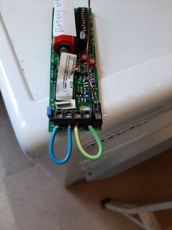

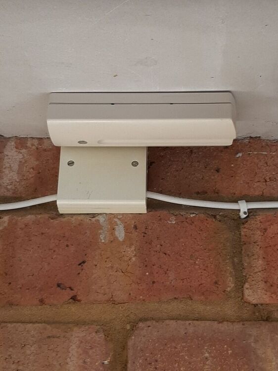

Problem still the same . I removed board and replaced it with the one  on front door( which works fine)  which requires no additional wires, ( just the board in casing on door frame and a magnet on the door ) without changing any of the dip switches. It does not read the magnet on the front door. If unit was ok I would expect it to read that zone. As soon as you open or close the door under normal circumstances the red led light should come on.
My deduction is the unit communicates ok with scantronics 4600 control box.
The tempers work ok because if if move the board in your hand the tamper alarm goes off.
It does not read contact with door magnet.
I found a scantronics control box and 3 pirs on Ebay 2nd hand but could be a risk. If I could replace faulty contact with a pir in the same location that would work. Any advice or would I be wasting my money

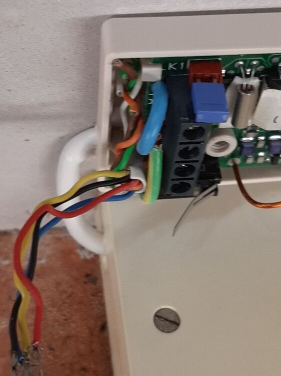

is there links in the connections on the one from the front door?
iirc the external and reed are series connections so if there is no link the contact built in wont function either
Tried looping cables and re inserted board into housing and tested it but the tamper alarm always goes when when trying a walk test
On the front door is only the unit. There are no cables at all. All 4 terminals are empty.

Sorry meant to add enabled battery dip switch for testing purposes
im not sure i recall that panel due to age but is the zone light on as well or just the tamper light. Also when you close both tamper switches do you get the tx led to flash on the contact?
Yes the zone in question also illuminates. I had taped both tamper switches. The red led can still set the tamper alarm on the 4600 panel

ok then id next be metering the back of the board on each switch to see if the tamper switches themselves. If not it is totally knackered

so you appear to have either got a fault on the tamper switch or the tamper terminals
if you've very luck you may be able to bridge the switch or rework the terminals with an iron.
also work all the dil switch up & down a few times, just encase the address is not right
