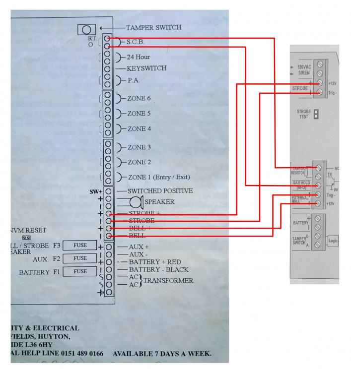

    I'd say all looks correct but the SCB return should be in TR not NC (which I assume from the diagram to mean "No Connection" and not "Normally Closed") As for the electronics behind the panel I h
  • Swb must be talking in general as each manufacturer can make there outputs different
  • Have you done it and what's the issue ?
