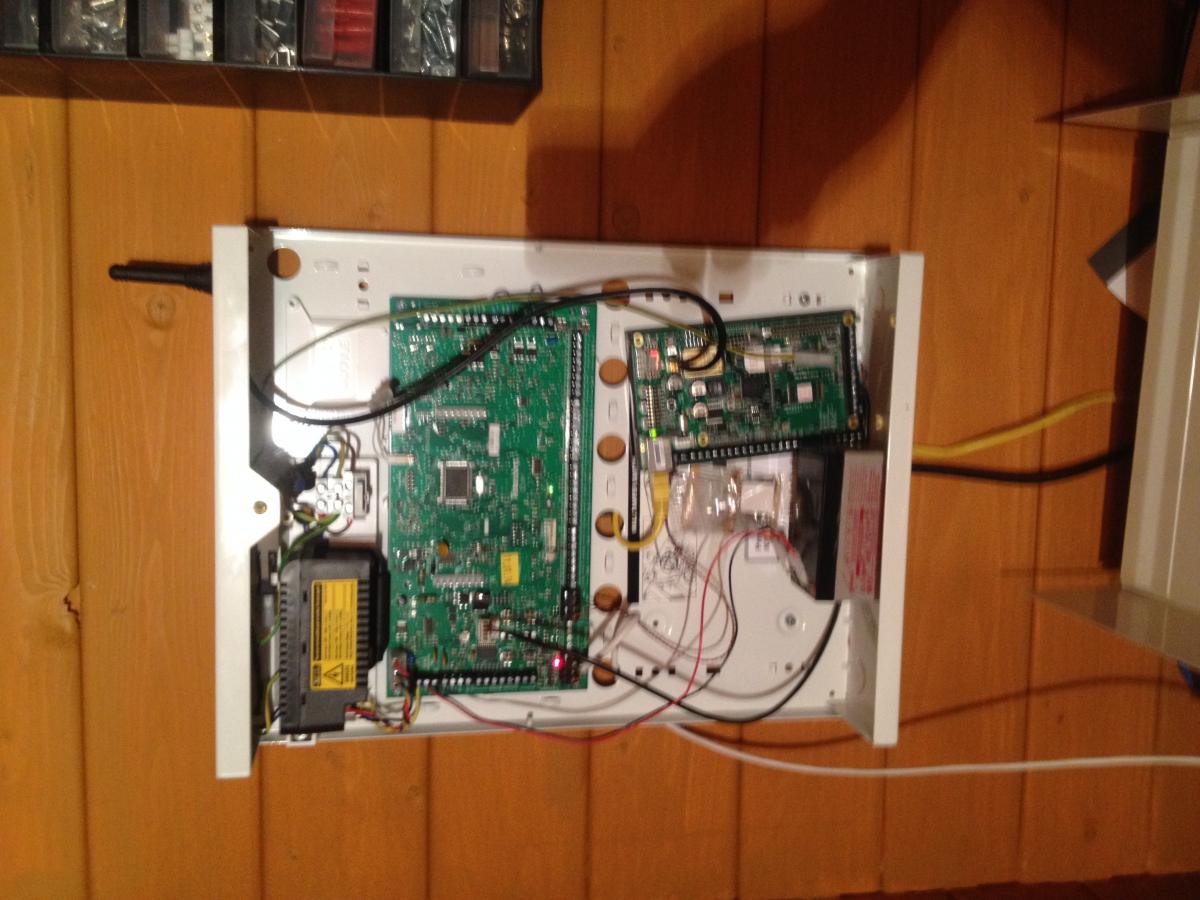

matthew.brough Posted April 4, 2014 Share Posted April 4, 2014 i dont know the texecom panel so you may be right Imagine a 17ah in here www.securitywarehouse.co.uk/catalog/ Link to comment https://www.thesecurityinstaller.co.uk/community/topic/36438-speaker-vs-bell-on-texecom-premier/page/6/#findComment-376045 Share on other sites More sharing options...

sixwheeledbeast Posted April 4, 2014 Share Posted April 4, 2014 It will fit a 17Ah and that's fine There's also no reason you can't use one 17AH in the PSU200 either... However, in my experience anything >12Ah are pants and don't last, especially after recovering from a power failure. We no longer use anything greater than 7Ah after many premature failures of a few different brands. 12Ah will not fit in the Texecom cab BTW. Link to comment https://www.thesecurityinstaller.co.uk/community/topic/36438-speaker-vs-bell-on-texecom-premier/page/6/#findComment-376072 Share on other sites More sharing options...

matthew.brough Posted April 4, 2014 Share Posted April 4, 2014 Where do you fit the Comms with a 17ah in? No excuse there for it being on the piss. You excell yet again. Erm who rattled your cage? I slammed it on the wall to test a firmware update and it's going back in the garage. www.securitywarehouse.co.uk/catalog/ Link to comment https://www.thesecurityinstaller.co.uk/community/topic/36438-speaker-vs-bell-on-texecom-premier/page/6/#findComment-376074 Share on other sites More sharing options...
norman Posted April 4, 2014 Share Posted April 4, 2014 Glanded psu. Nothing is foolproof to a sufficiently talented fool. Link to comment https://www.thesecurityinstaller.co.uk/community/topic/36438-speaker-vs-bell-on-texecom-premier/page/6/#findComment-376077 Share on other sites More sharing options...
matthew.brough Posted April 4, 2014 Share Posted April 4, 2014 Glanded psu. What? www.securitywarehouse.co.uk/catalog/ Link to comment https://www.thesecurityinstaller.co.uk/community/topic/36438-speaker-vs-bell-on-texecom-premier/page/6/#findComment-376079 Share on other sites More sharing options...
sixwheeledbeast Posted April 4, 2014 Share Posted April 4, 2014 Where do you fit the Comms with a 17ah in?Depends on the product. It was designed to take the footprint Redcare GSM/Dualcom, when using a 17Ah. As I say don't use 17Ah's any more. Link to comment https://www.thesecurityinstaller.co.uk/community/topic/36438-speaker-vs-bell-on-texecom-premier/page/6/#findComment-376084 Share on other sites More sharing options...
