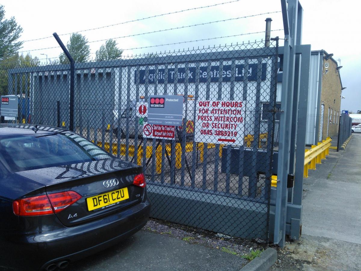

james.wilson Posted May 14, 2013 Author Share Posted May 14, 2013 I did think you would say NICE and meant to look at them at ifsec today. Is it up to the duty and weight, its a petrol tanker depot this gate the image shows the gate and workshop only. securitywarehouse Security Supplies from Security Warehouse Trade Members please contact us for your TSI vetted trade discount. Link to comment https://www.thesecurityinstaller.co.uk/community/topic/34578-gates/#findComment-320582 Share on other sites More sharing options...
