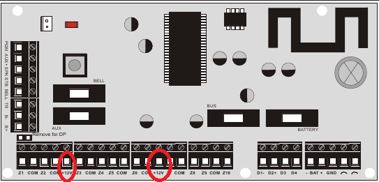

SoupDragon Posted September 19, 2012 Author Share Posted September 19, 2012 Tested this morning with my multimeter and was getting 246, I'll test it again when the ups clicks over to AVR trim. I've planned my cable runs so not to go anywhere near mains wiring. This is where the ac filters would go? Providing I had over 1.2vac being measured. Link to comment https://www.thesecurityinstaller.co.uk/community/topic/33381-advice-on-sensor-positions/page/10/#findComment-290553 Share on other sites More sharing options...
SoupDragon Posted September 19, 2012 Author Share Posted September 19, 2012 or filter would go into one of those... I'd only need one right? Link to comment https://www.thesecurityinstaller.co.uk/community/topic/33381-advice-on-sensor-positions/page/10/#findComment-290556 Share on other sites More sharing options...
sixwheeledbeast Posted September 19, 2012 Share Posted September 19, 2012 One of the filters is a mains filter, you wire from the spur to the filter and use the filtered output in your mains connections. The 1313 is a low voltage spike suppressor this has three wires a 12 positive, a 0V negative and a mains earth. You only require one of each filter. FYI the filters come with destructions. Link to comment https://www.thesecurityinstaller.co.uk/community/topic/33381-advice-on-sensor-positions/page/10/#findComment-290558 Share on other sites More sharing options...
SoupDragon Posted September 19, 2012 Author Share Posted September 19, 2012 One of the filters is a mains filter, you wire from the spur to the filter and use the filtered output in your mains connections. The 1313 is a low voltage spike suppressor this has three wires a 12 positive, a 0V negative and a mains earth. You only require one of each filter. FYI the filters come with destructions. thanks, I'll defiantly be getting a 1313 then, just as a precaution. Link to comment https://www.thesecurityinstaller.co.uk/community/topic/33381-advice-on-sensor-positions/page/10/#findComment-290559 Share on other sites More sharing options...

sixwheeledbeast Posted September 19, 2012 Share Posted September 19, 2012 Most don't need one. True, most sites with metal end stations and cables away from mains don't. It was mentioned how to test if you need one above. Ox's Post. Test between a 12Vdc connection and mains earth on your lowest AC range; if over 1.2Vac fit one. Sometimes putting your spare cores to earth can do the same thing, depends on the installation. Link to comment https://www.thesecurityinstaller.co.uk/community/topic/33381-advice-on-sensor-positions/page/10/#findComment-290567 Share on other sites More sharing options...

SoupDragon Posted September 20, 2012 Author Share Posted September 20, 2012 The Euro Mini not have a decoupling capacitor built in? Link to comment https://www.thesecurityinstaller.co.uk/community/topic/33381-advice-on-sensor-positions/page/10/#findComment-290632 Share on other sites More sharing options...
