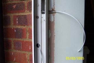

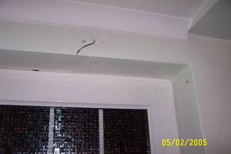

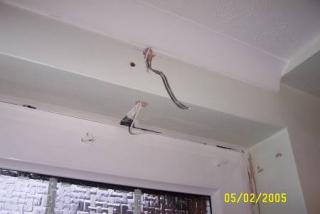

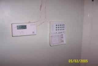

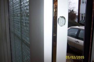

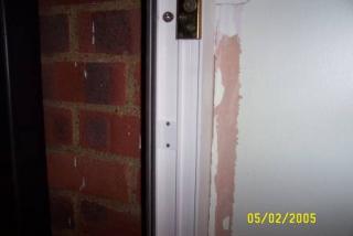

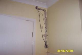

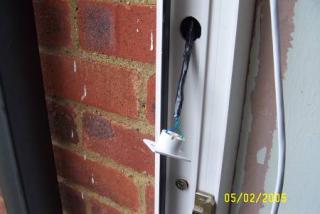

Guest Chewie Posted February 5, 2005 Share Posted February 5, 2005 Well I made a start today running the cables and fitting a contact on the front door. What I have decided on. Zone1 Front door contact. Zone2 Hall PIR Zone3 Garage door contacts, patio door contact and back door contact Zone4 Living room PIR, will also cover dining room so no need for a PIR there. Zone5 Study PIR Zone6 Kitchen PIR Zone7 Landing PIR Zone8 Smoke detectors Bellbox at front of the house An extension speaker in the hallway A RKP in the hallway and one outside the master bedroom on the landing. Texecom speech dialler. Thanks again to everyone who offered advise, I will keep you posted on how I am doing. Here are some pics, I decided on the flush door contacts as they are much neater. Fitting the wired contact in the frame was no problem. It was the magnet in the door that caused problems. There was some steel channel right in the middle of the hole I drilled in the door. Used a dremel to remove a section of the steel to fit the magnet. Link to comment https://www.thesecurityinstaller.co.uk/community/topic/4924-door-contacts-or-pirs/page/6/#findComment-39402 Share on other sites More sharing options...
