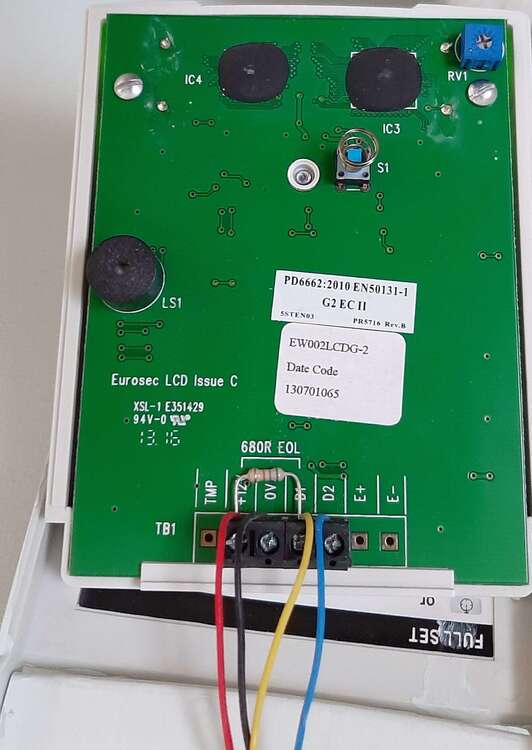

I have a Eurosec CP8L alarm, installed by the builder. About 2 years I had to replace the main battery, but other that it was functioning fine. Recently I started getting tamper alarms at random times through the day, not too often yet, but few late at night - so this is annoying. It is very similar to False Tampers Eurosec Cp8l Lcd topic from years ago, but I do get a definite code for "KP Tamper" when it happens. I unscrewed keypad panel and the button on the back of the board seems to be functioning as intended with spring looking ok (and triggering legitimate KP Tamper when I take the panel off). Other than that the KP board looks fine (pics attached).

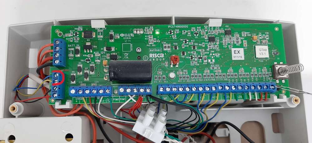

I also looked at control panel board, but also didn't see anything obvious. I connected/disconnected KP tamper wires (left hand side - highlighted in red in pics - they seem to be doing their job triggering KP Tamper as expected).

if all the terminals are tight and the spring is good then I would say dry joint somewhere on the rkp. Though the top of the rkp PCB looks like its had some water damage thats spilled out onto the label in the lid

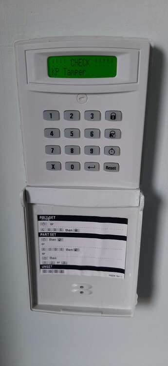

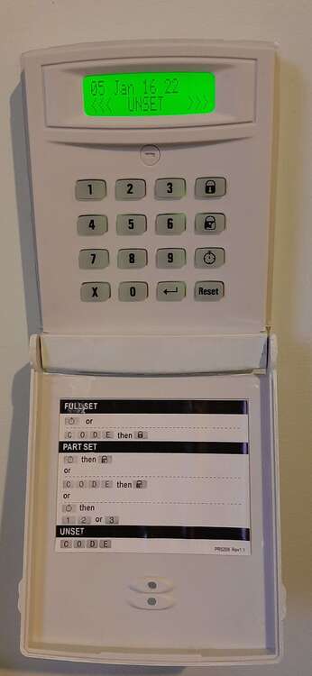

I noticed that occasionally (random times) on CP there are beeps as if I am pressing buttons on KP (obv. without  anyone pressing anything). After tamper alarm, if I only enter my code in, it still keeps the message "!!CHECK!! KP Tamper"  - if I don't do anything else, it keeps it and keeps other KP false alarms at bay . Which fine as I work from home, but obv renders the system useless. If I preset Reset - it goes back to "unset" state (as my first pic) and then after some random time "KP Tamper" can happen. So very recently - it took me quite awhile to make it shut up. I noticed that when I press keys on KP and the beeps are duplicated on CP the code works fine. But recently when I pressed it was only beeping on KP and wasn't making any effect ... after some time (~1-2-3 min) it started working again (with duplicating beeps on CP) so I turned it off.  So looks like the culprit is either on KP pcb, KP -> CP wiring or maybe there is some circuitry on CP? ?
