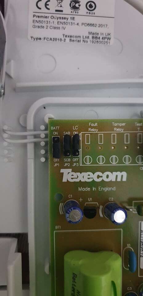

Where did you get bell? Is bell tamper closed?
Does bell have jumpers you can take picture of
Actually I see the jumpers

17 minutes ago, sixwheeledbeast said:
They have an engineer hold off mode and will not be full operation with the lid open.
I Put jack in off for LC stay the same
