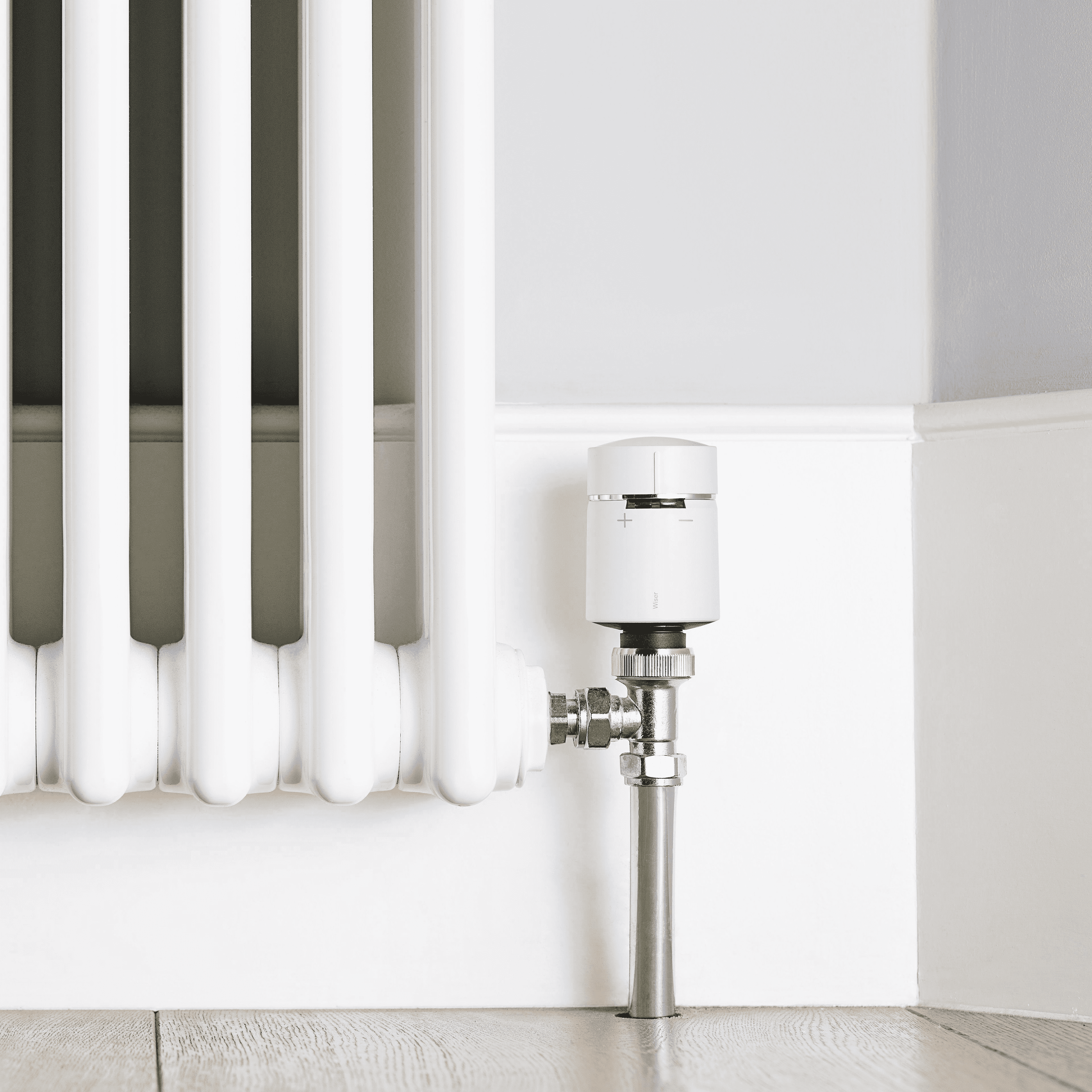

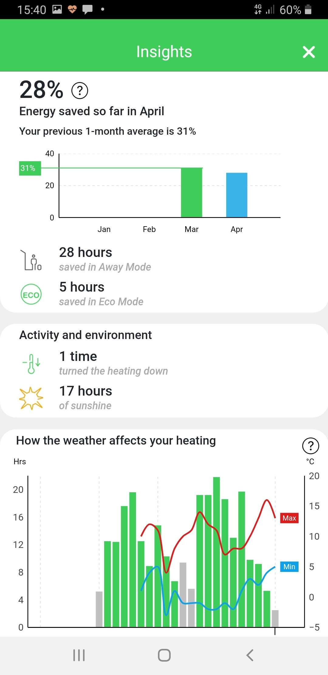

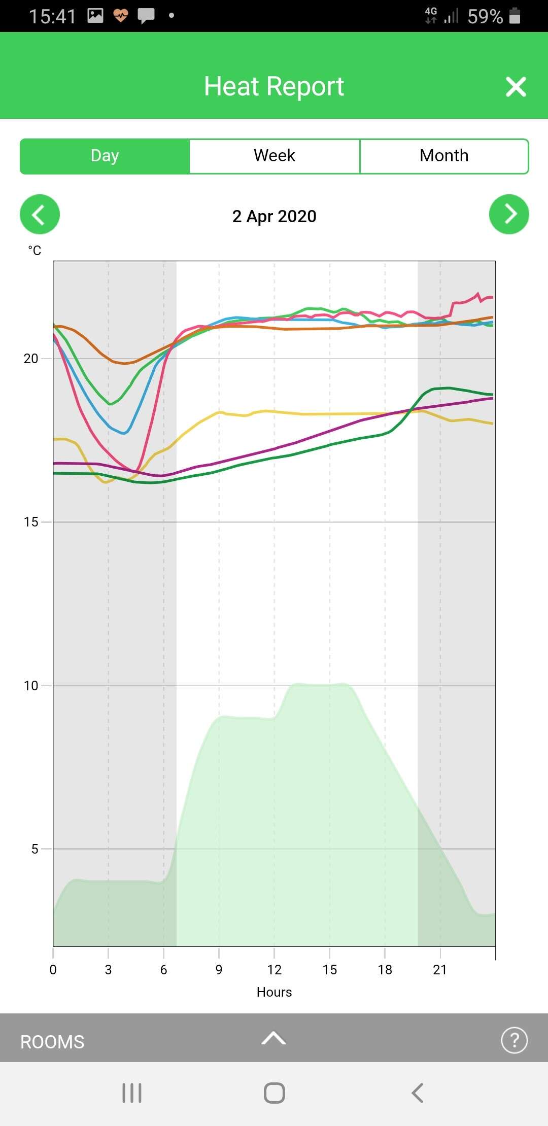

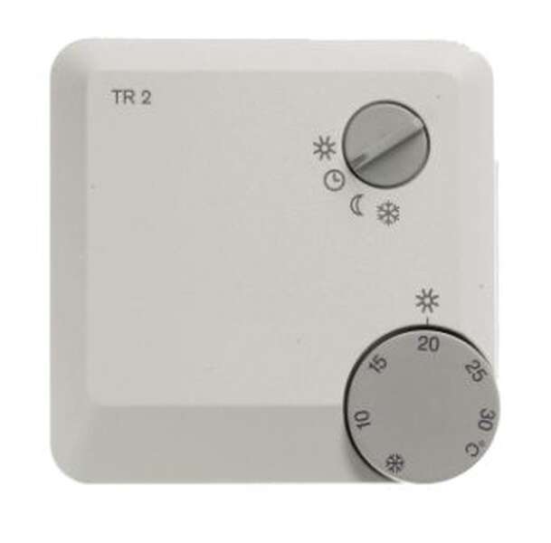

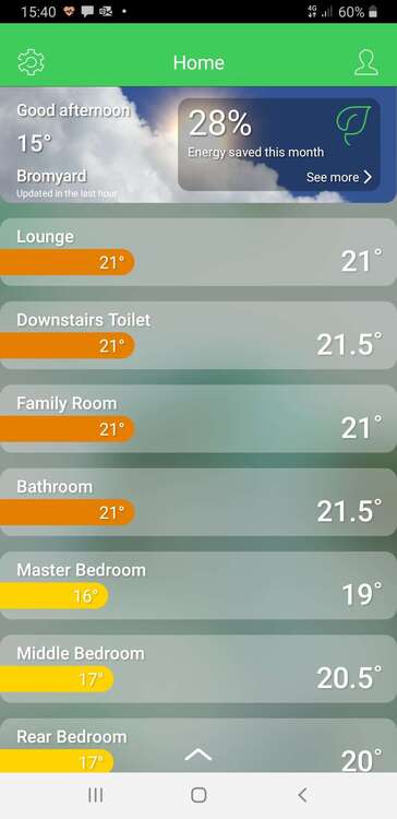

james.wilson Posted April 6, 2020 Share Posted April 6, 2020 Following on from another thread. I use ifttt and my hkc 10270 with my drayton wiser heating system As it change the mode to away when fully armed i use a modified tr2 as my boiler is too old to support opentherm As the tr2 measures the (single room its located in) temp the boiler still modulates its power output rather than just on and off The wiser system then calls for heat by changing the boiler mode to 'comfort' from frost Plus im on LPG so any savings are magnified due to the fuel cost. Some rooms have more than 1 radiator. I prefer the accuracy of the room stats and will be getting at lease 1 more of these Quote securitywarehouse Security Supplies from Security Warehouse Trade Members please contact us for your TSI vetted trade discount. Link to comment Share on other sites More sharing options...
norman Posted April 6, 2020 Share Posted April 6, 2020 Looks good and I like the controlability of rooms independently, I currently just shut off any rooms we don't use (on this house we don't even have TRV's!) I will update to wireless ones when they are a bit more compact and the battery life gets better. My boiler is c20 years old but I'm not going to replace it until it fails, the roi isn't there for me so we still have the boiler and an immersion heater. Quote Nothing is foolproof to a sufficiently talented fool. Link to comment Share on other sites More sharing options...

james.wilson Posted April 6, 2020 Author Share Posted April 6, 2020 battery life im unsure of, but worst case ill change to 1.5v lithiums Opentherm does work on zones, i run my zones as rooms you can add upto 8 (iirc) trvs per room so opentherm would call for heat output from the boiler based on heat required for the rooms calling for it etc. Nest wouldnt work for me which is why i went for the drayton. The trv's arnt mesh so require powered boosters if range is an issue but in my old cottage I didnt need any Quote securitywarehouse Security Supplies from Security Warehouse Trade Members please contact us for your TSI vetted trade discount. Link to comment Share on other sites More sharing options...
