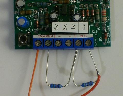

Ok, I understand why you've gone for the Activ8's fair enough. Any device with alarm and tamper loops can be converted to EOL,
as I understand it the panel should come with 16 1K resistors. like this except I have NO idea why they've soldered it, just use the terminals!
md-pir-1-connections_large.jpg?128868464
I know nothing about the flex so someone else will be along shortly to explain which expander(s) you need.
You can do the same for the contact as above BUT I recommend you spend an extra £6 and buy an EOL contact with
them built in, trust me doing it with resistors (unless you have the kind of contact with proper terminals rather than
screw heads) is asking for trouble later!
