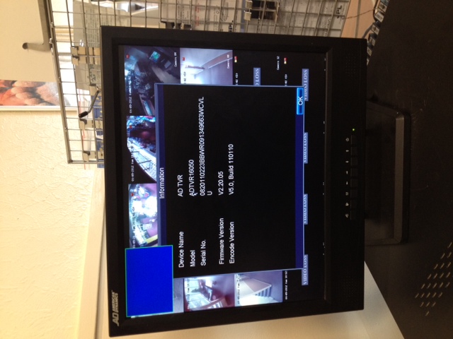

glasmale26 Posted September 4, 2012 Share Posted September 4, 2012 Hi, I have an AD CCTV that has developed a little blue screen in the top left hand corner of the monitor that I cant get rid off. I have enclosed a pic as the cameras still run behind it but I obviously cant see what is on that part of the camera. Can anyone shed any light before I need to call out the engineer? Thanks Link to comment https://www.thesecurityinstaller.co.uk/community/topic/33367-american-dynamics-cctv-system/ Share on other sites More sharing options...
james.wilson Posted September 4, 2012 Share Posted September 4, 2012 picture in picture mode on the monitor itself? securitywarehouse Security Supplies from Security Warehouse Trade Members please contact us for your TSI vetted trade discount. Link to comment https://www.thesecurityinstaller.co.uk/community/topic/33367-american-dynamics-cctv-system/#findComment-289486 Share on other sites More sharing options...
sixwheeledbeast Posted September 4, 2012 Share Posted September 4, 2012 I'd say it was a setting on the monitor (Maybe PIP or Privacy). Has someone been playing with the monitor buttons? Link to comment https://www.thesecurityinstaller.co.uk/community/topic/33367-american-dynamics-cctv-system/#findComment-289488 Share on other sites More sharing options...

Scotmod Posted September 4, 2012 Share Posted September 4, 2012 Stick your test monitor on the camera input and see if its a camera/dvr/monitor issue. Link to comment https://www.thesecurityinstaller.co.uk/community/topic/33367-american-dynamics-cctv-system/#findComment-289497 Share on other sites More sharing options...
sixwheeledbeast Posted September 4, 2012 Share Posted September 4, 2012 Can anyone shed any light before I need to call out the engineer? From this I am guessing the OP doesn't have a test monitor handy. Link to comment https://www.thesecurityinstaller.co.uk/community/topic/33367-american-dynamics-cctv-system/#findComment-289498 Share on other sites More sharing options...

norman Posted September 4, 2012 Share Posted September 4, 2012 Looks like the menu screen but without the menu, downpower and restart the monitor (leave for 30 seconds) and if no joy call your maintainer. Nothing is foolproof to a sufficiently talented fool. Link to comment https://www.thesecurityinstaller.co.uk/community/topic/33367-american-dynamics-cctv-system/#findComment-289500 Share on other sites More sharing options...
Oxo Posted September 4, 2012 Share Posted September 4, 2012 Agreed, downpower (But everything) wait 30 secopnds and reboot. You would do the same with your PC/DVR/SKY Box would you not????? Link to comment https://www.thesecurityinstaller.co.uk/community/topic/33367-american-dynamics-cctv-system/#findComment-289511 Share on other sites More sharing options...
