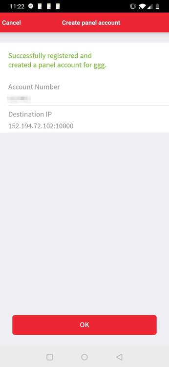

	The destination IP, port and account number can be applied to the Alarm Monitor or ARC sections. You must also be transmitting in SIA format.
	They should be emailed to the email address you set up via the app. Just a server address, port number and account number.
