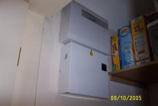

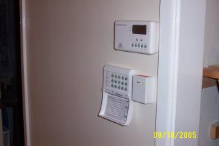

Adi Posted October 10, 2005 Share Posted October 10, 2005 Get a couple of stickers for your external sounders, even if you make up a name a local printer/graphics shop will sort them out for a couple of quid. Looks nice and neat but as others have said why a G3 panel and the PA buttons. I agree with your reasons tho, but i would have rather put red rings round the appropiate numbers i dont know why manafactures dont do it. Sound detectors tho. You can have your name scrolling on the dialler if you want just for a gimmick. I really can't be ar**** with it anymore. Link to comment https://www.thesecurityinstaller.co.uk/community/topic/7754-a-massive-thank-you/page/2/#findComment-71577 Share on other sites More sharing options...
Guest G.J.M Posted October 10, 2005 Share Posted October 10, 2005 even has the mains coming through a seperate inlet. Link to comment https://www.thesecurityinstaller.co.uk/community/topic/7754-a-massive-thank-you/page/2/#findComment-71580 Share on other sites More sharing options...

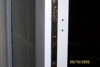

Guest Chewie Posted October 10, 2005 Share Posted October 10, 2005 One of the worst bits of the install was fitting the mag contacts in the PVC doors. They needed fitting right where the steel reinforcing was in the door. Took hours grinding away with a dremel. If you look closely at the pic you can see where I ground the steel away Link to comment https://www.thesecurityinstaller.co.uk/community/topic/7754-a-massive-thank-you/page/2/#findComment-71605 Share on other sites More sharing options...
Service Engineer Posted October 10, 2005 Share Posted October 10, 2005 If you look closely at the pic you can see where I ground the steel awayNot many installers would have gone to that trouble.. A slightly angled surface mount would have done the trick..You realise you may have invalidated your 10yr door guarantee..? ........................................................ Dave Partridge (Romec Service Engineer) Link to comment https://www.thesecurityinstaller.co.uk/community/topic/7754-a-massive-thank-you/page/2/#findComment-71609 Share on other sites More sharing options...
Guest Chewie Posted October 10, 2005 Share Posted October 10, 2005 Doors were fitted when I bought the house, no idea who installed them, so not worried about guarantees. Thats the beauty of a DIY install, I can take as much time as I like making sure that it is just as I want it. Some of the things I did would be prohibitively expensive for a professional installer working to a price. Link to comment https://www.thesecurityinstaller.co.uk/community/topic/7754-a-massive-thank-you/page/2/#findComment-71615 Share on other sites More sharing options...

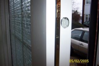

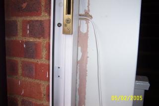

Paul Giles Posted October 10, 2005 Share Posted October 10, 2005 Couple things, flush contacts on outward opening doors. audible only is a dying breed, should any company take it over for monitoring they would have to upgrade the panel causing disruption, i know you already had the panel but cant help thinking it would have been better to have it monitored? PG Security Systems Somerset SSAIB Certificate of Merit Installers. www.pgsecurity.co.uk Link to comment https://www.thesecurityinstaller.co.uk/community/topic/7754-a-massive-thank-you/page/2/#findComment-71618 Share on other sites More sharing options...
Service Engineer Posted October 10, 2005 Share Posted October 10, 2005 Isn't this inwards opening.? But yeah looks like the other shots are outward opening.. ........................................................ Dave Partridge (Romec Service Engineer) Link to comment https://www.thesecurityinstaller.co.uk/community/topic/7754-a-massive-thank-you/page/2/#findComment-71621 Share on other sites More sharing options...
