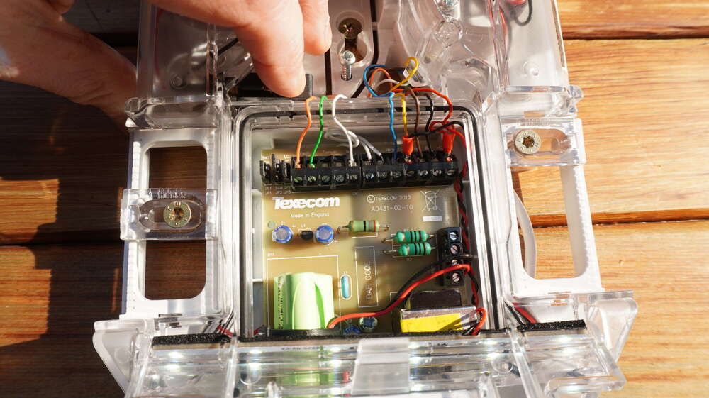

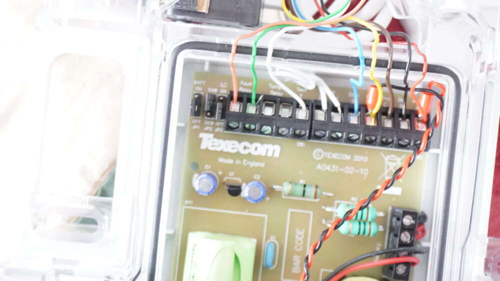

can anyone tell me if my wiring looks OK please?

So you have it wired as a Grade 3 bellbox and it's maybe failed one of the G3 self tests I'd guess?
Assuming you have everything wired and programmed correctly on a Premier panel that is.

looks poorly terminated...

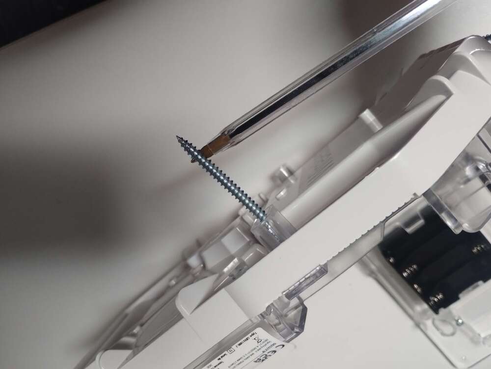

I fix them with two x 3x10 & one x  2x10 screws

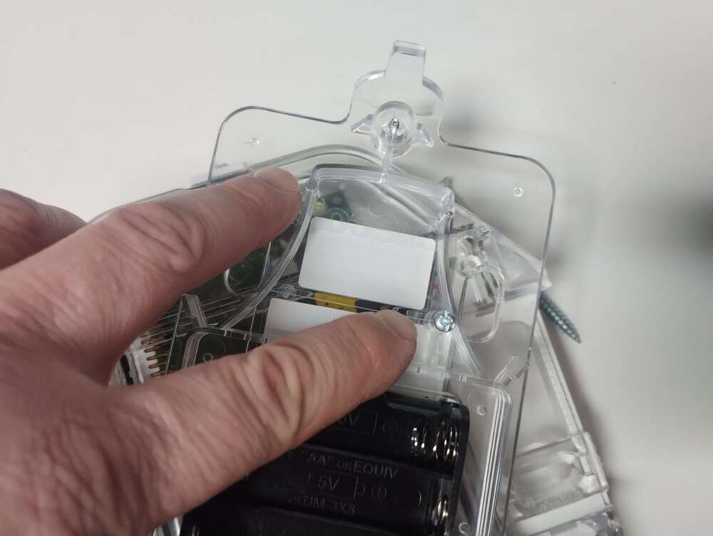

A tamper fault is most likely to be the small machine screw needing releasing to make a good contact.

Resistor missing
Back plate screw is my bet if it has one

odd product, you can remove the outer cover & throw it away with out the alarm goinoff,
the internals are all clear plastic, the drop down lid has a machine screw to make contact with the mirco switch,
the adjustable lower fixings stand off the wall by 30mm hence 3 inch screws,

Is it a bad tamper switch? or my wiring wrong?
Does anyone know the settings for it? in the setting up?
the way its wired?
Im releasing the small plastic cover tamper screw so should press against the switch better and tidying up the wires as i put a nought in the outer sheath!
