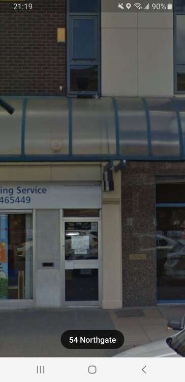

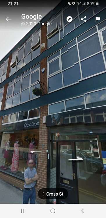

  • You'd never be brave enough to go to Wakefield it's that rough even the muggers have to go out in pairs....

    Maybe, that wasn't the question tho.
