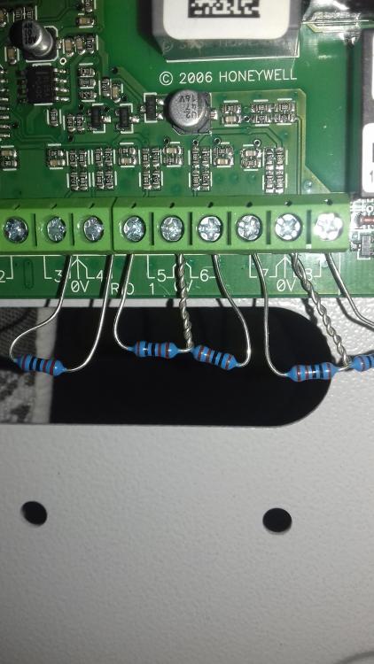

Hi James,
Thanks for the reply.
Just to get it clear in my head, could you give me a little more direction on the position of the 1k resistors.
My understanding is that these are fitted to the RIO Zones on the bottom of the board I have taken a photo of of my panel.
As such in order to 'short' zones 1014,1015,1016,1017 and 1018 I would put resistors in the following:
In the Section Marked 'RIO 0' I would put a resistor across the '1', thus relating it to RIO ADDRESS 01.
In the Section Marked 'RIO 1' I would put resistors across the '4,'5,6,7,8', thus giving me the Zone Addresses 4,5,6,7,8.
Is this correct??
James
