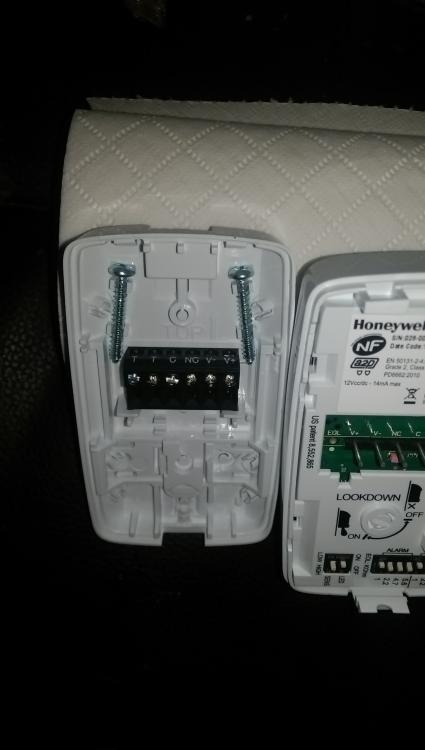

Here's the thing. A basic PIR only detects infra read heat. Right? In particular infra red radiation that is above that of the surrounding environment. Furthermore, having tested mine, they only trigger when that "hot spot" is moving. They are basically motion sensors. The same as the technology I have in the toilets that turn the lights on when someone walks in.  And loose bricks tend to be at ambient temperature. So I wouldn't expect a basic PIR to detect a flying brick unless the brick had been basking in the sun so that it was significantly hotter than the space around it. But that's a bit hit and miss. So I am looking for something that doesn't rely on infra red radiation. That's why I have gone for the Dual TEC infra red and microwave technology.
Yes, the pyroelectric sensor detects infra red radiation.  It also detects the pattern of the surrounding ambient environment.  If a flying object manages to disrupt that environment across the planes/zones, then the device will trigger.  The closer the object is to the element, then the bigger the disruption to the planes/zones. So, a flying object that doesn't perfectly match the background temp of each plane/zone can trigger the PIR. The object doesn't need to be hot, just not a match for each individual plane/zone.  As above, still not a reliable detection method.
You've gone for a dual tec, but probably wanted a microwave only or multi-beam active IR detector, as dual-tec devices will not trigger on microwave detection alone.
Thanks GalaxyGuy. Now that's an answer. I appreciate it.

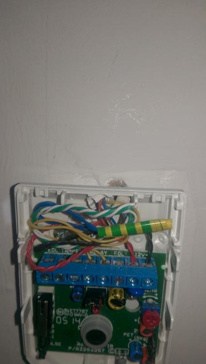

Did I follow this correctly? A grand for that shoddy work?
Movement detectors are designed to detect people walking across them, yes they can pick up other things due to how they work but that's what they are designed to do.
You shouldn't be expecting a PIR or DT to detect this type of incident
There is more to alarms than sticking coloured wires in holes, understanding how detection works and what type you need for the environment is all part of the job.
If you want to detect the window being put in, I suggest using a method capable of this.
