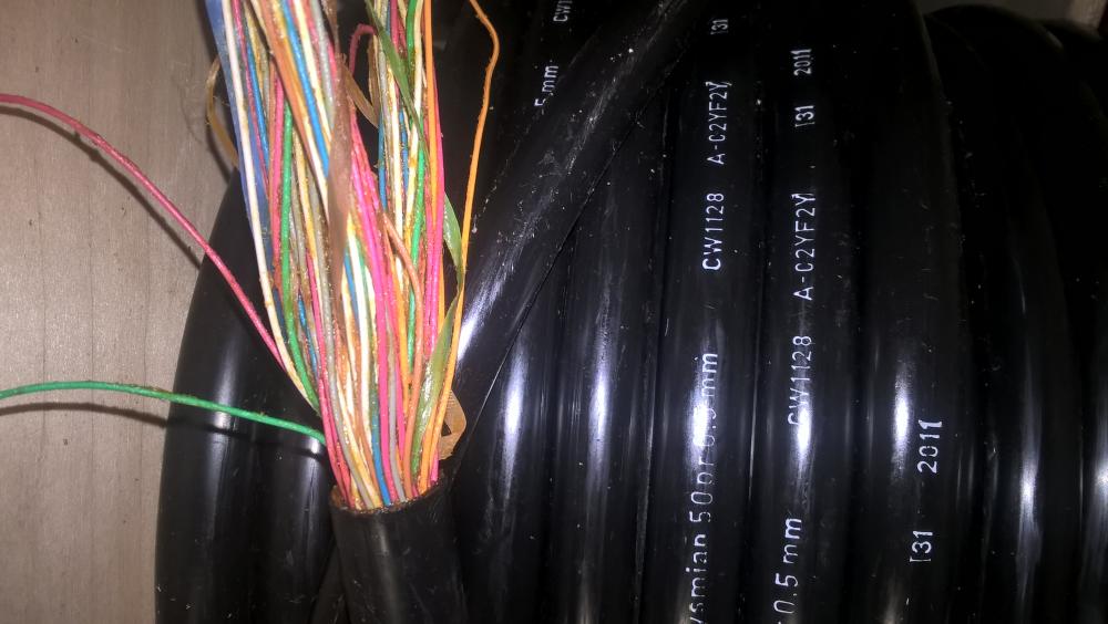

August 19, 201610 yr comment_449427 hi all. I'm after some advice about cabling for relocating 2x 16 ch DVRs, the cameras are connected via balun using cat5 cable. the dvrs are getting relocated to another room but I need to extend all 32 cat5 cables and was wanting to know if there was another way other than running 32 cat5 to new location. in the past I have seen the below cable used, Is it any good? Link to comment https://www.thesecurityinstaller.co.uk/community/topic/40380-moving-cctv-dvrs/ Share on other sites Share on LinkedIn Share on X Share on Facebook {lang="reddit_text" Share via email Share on Pinterest More sharing options... Share this post
August 19, 201610 yr comment_449428 Well, for a start each camera only uses 1/4 of a Cat5 cable, so you would only be running 8... And to be honest 8 isn't so bad, so I wouldn't risk an all-in-one cable esp. as the number of twists per metre might not match true Cat5 spec.. And it's usually covered in disgusting protective jelly, which I would hate to get involved with indoors (I'm assuming the new room is in the same building) I take it they really, really do have to move by the way, not just that some manager misunderstands that they can (presumably) be accessed remotely via the net? Or do they have a live operator jacking straight into monitors and PTZ etc...? Edited August 19, 201610 yr by datadiffusion So, I've decided to take my work back underground.... to stop it falling into the wrong hands Link to comment https://www.thesecurityinstaller.co.uk/community/topic/40380-moving-cctv-dvrs/#findComment-449428 Share on other sites Share on LinkedIn Share on X Share on Facebook {lang="reddit_text" Share via email Share on Pinterest More sharing options... Share this post
August 19, 201610 yr comment_449429 36 minutes ago, danlad1980 said: hi all. I'm after some advice about cabling for relocating 2x 16 ch DVRs, the cameras are connected via balun using cat5 cable. the dvrs are getting relocated to another room but I need to extend all 32 cat5 cables and was wanting to know if there was another way other than running 32 cat5 to new location. in the past I have seen the below cable used, Is it any good? Looks like gel filled copper cable , you havnt seen it on Cctv Link to comment https://www.thesecurityinstaller.co.uk/community/topic/40380-moving-cctv-dvrs/#findComment-449429 Share on other sites Share on LinkedIn Share on X Share on Facebook {lang="reddit_text" Share via email Share on Pinterest More sharing options... Share this post

August 19, 201610 yr comment_449432 Lol, if it's Poe then it's IP and if you try and use the cable in the image God help you sorting it all out. looks like you will need to run 32 cat5s or can you not fit a coupe of Poe switches in the current NVR locations? Link to comment https://www.thesecurityinstaller.co.uk/community/topic/40380-moving-cctv-dvrs/#findComment-449432 Share on other sites Share on LinkedIn Share on X Share on Facebook {lang="reddit_text" Share via email Share on Pinterest More sharing options... Share this post
