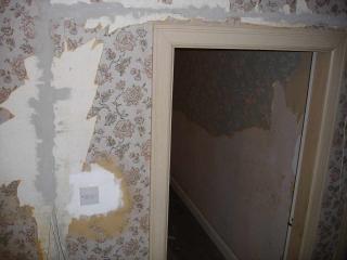

Guest mike2004 Posted October 27, 2004 Share Posted October 27, 2004 You could use one of the 2 zones on the control panel for the door contact. This would free up a zone to split up your zone 3 dining/lounge. 28186[/snapback] Further to your cunning suggestion, I've chased in a run for 2 new cables from the site of the keypad to the PIRs in the lounge and diningroom. This will free up 2 zones from the main panel, allowing more expandability. (Good to have had the chance to do this at this stage, before the redecoration - in matching wallpaper, obviously!): Link to comment https://www.thesecurityinstaller.co.uk/community/topic/3962-photos-of-alarm-system-installation/page/10/#findComment-29590 Share on other sites More sharing options...
Guest Posted October 27, 2004 Share Posted October 27, 2004 Looks to me like the horizontal chase is running in the middle of nowhere, how far above it is the ceiling? Link to comment https://www.thesecurityinstaller.co.uk/community/topic/3962-photos-of-alarm-system-installation/page/10/#findComment-29593 Share on other sites More sharing options...
CompostCORNER Posted October 27, 2004 Share Posted October 27, 2004 Yeah. Not being funny but where that chase is, I would be nailing my prize collection of spent condoms there. I'd have been whizzed by 240vac, pushing up the daffs and that, all because I nailed through a mains cable trying to display a shelf containing the tokens of my sexual conquest. Link to comment https://www.thesecurityinstaller.co.uk/community/topic/3962-photos-of-alarm-system-installation/page/10/#findComment-29600 Share on other sites More sharing options...

Guest mike2004 Posted October 28, 2004 Share Posted October 28, 2004 Looks to me like the horizontal chase is running in the middle of nowhere, how far above it is the ceiling? 29593[/snapback] Its about 70cm further up. The horizontal chase continues off the right of that photo, into and up a small alcove, where it drills out into the corners of the lounge and dining rooms, for their PIRs. In the same alcove, it is joined by the cable runs from the panel to the hall PIR and the soundbomb. Yeah. Not being funny but where that chase is, I would be nailing my prize collection of spent condoms there. I'd have been whizzed by 240vac, pushing up the daffs and that, all because I nailed through a mains cable trying to display a shelf containing the tokens of my sexual conquest. 29600[/snapback] Well, what can I say! I don't know what would look worse: the present wallpaper or your trophy collection! Anyway, you'll be pleased to know there's no 240v in my alarm cables and in 8 zone control panel if using DP there is a separate tamper "zone" for every zone? 29618[/snapback] In the Premier there's 4 terminals (A,A,T,T) for every zone input, so every zone has its own N/C tamper loop. Link to comment https://www.thesecurityinstaller.co.uk/community/topic/3962-photos-of-alarm-system-installation/page/10/#findComment-29671 Share on other sites More sharing options...
