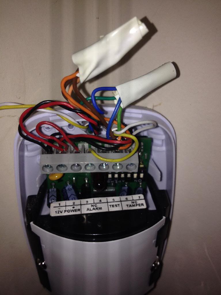

9651 Posted January 30, 2014 Author Share Posted January 30, 2014 I'll try it. So it might work? As said there's various points round the house fed from the unit by the router. I was hoping just to plug the wired pair Sync up, job done. Ill plug them in when I get to site tomorrow before I wire the cameras, see how they go. Been sorting the alarm today, Windsor panel (first I've seen round here) binned for a galaxy, but what a mare. Had to extend every cable at the panel end, and there's been some weird and wonderful wiring in the house. It's had systems since 1974 lol, constant hashing from Chubb down the years has lead to some 'interesting' wiring shall we say..... Link to comment https://www.thesecurityinstaller.co.uk/community/topic/36051-power-line-adaptors/page/2/#findComment-365713 Share on other sites More sharing options...

antinode Posted January 30, 2014 Share Posted January 30, 2014 Nice single wire return! I'm amazed they managed to get the lid back on that Apollo with all the cable in there lol Trade Member Link to comment https://www.thesecurityinstaller.co.uk/community/topic/36051-power-line-adaptors/page/2/#findComment-365730 Share on other sites More sharing options...

arfur mo Posted January 31, 2014 Share Posted January 31, 2014 Been sorting the alarm today, Anyone sane as me? I absolutely hate tape joints, let alone crammed into a detector or panel. The adhesive breaks down to a goo, it unwraps and goo gets into the joint, causes high ressistance AND gets sll over your ruddy fingers.If you really really must how longs it take go solder with a gas iron and heat shrink? - ggrrrrrrrrr!! Right - I feel much better - Back in me box If you think education is difficult, try being stupid!!!! Link to comment https://www.thesecurityinstaller.co.uk/community/topic/36051-power-line-adaptors/page/2/#findComment-365760 Share on other sites More sharing options...
