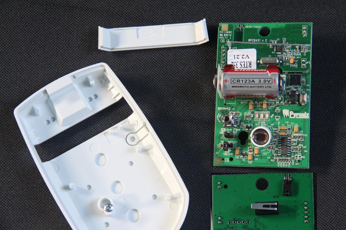

jiml Posted October 16, 2013 Share Posted October 16, 2013 Jim - what was the suspected issue? That the PIR could be removed without triggering the tamper? The old design has the back tamper on one side only. So if the detector was mounted in a corner but not right up against the corner, like in front of some furniture, then the tamper could be 50/50 hard to achieve. This was actually not the case as there is a wall and ceiling bracket for the detector which has it's own tamper switch for this purpose. That said, thew new design makes it hard to fit the detector without including the back tamper. It is easier and simpler. I am trying to work out how to include a picture in my post and I can show you. Link to comment https://www.thesecurityinstaller.co.uk/community/topic/35459-pyronix-wireless-pir/page/2/#findComment-349274 Share on other sites More sharing options...

jiml Posted October 16, 2013 Share Posted October 16, 2013 Pic of the new back tamper as promised. Jim you can upload images by pressing the reply button rather than quick reply which is below the topic Link to comment https://www.thesecurityinstaller.co.uk/community/topic/35459-pyronix-wireless-pir/page/2/#findComment-349319 Share on other sites More sharing options...
