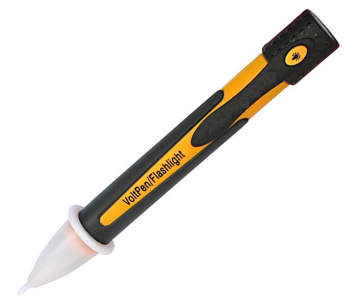

MrHappy Posted June 2, 2013 Share Posted June 2, 2013 Forgive this post please, from someone who does not own a volt stick of any kind. this type... If they are as dangerous as, nearly, everyone here, says, how come no one has pointed to a person who has been killed or seriously injured from using one of these. Has it happened? Using the magic of google, but note the dot au & its on page 5 Case 3 The deceased, who was a building and maintenance manager, received a fatal electrical injury whilst working on an air conditioning unit in their workplace. It appears that the deceased utilised a proximity volt- tester at the time of death since this device was discovered near the deceased’s head. “1. The Department of Fair Trading should review the adequacy of the precautions attached to the sale of proximity voltage testers (“volt sticks”) in light of their inherent unreliability and potentially fatal consequences. http://www.ncis.org.au/web_pages/Feb%202012%20FACT-SHEET%20-%20Electrocution%20related%20deaths.pdf How come they are sold in every DiY premises in the country and also many other outlets that sell electrical equipment. Same reason you can buy red plastic clips for FP, people want to buy 'em Mr Veritas God Link to comment https://www.thesecurityinstaller.co.uk/community/topic/34361-is-this-live/page/7/#findComment-325265 Share on other sites More sharing options...
