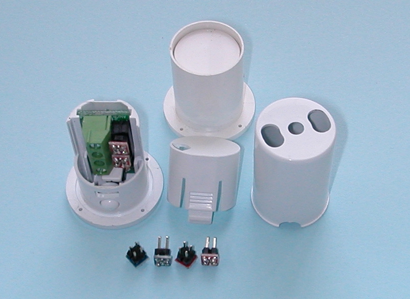

spike27 Posted November 6, 2012 Share Posted November 6, 2012 Following a recent discussion about new products being introduced without installer input, I fed this back to my MD and we are now putting a new product modification out to installers such as yourselves to get it user friendly first time. The current product is the YEND21 (G2 mini sized surface contact with selectable resistors) and XEND21 (G3 version)- see links below: http://www.knightfireandsecurity.com/view_item.asp?id=217 http://www.knightfireandsecurity.com/view_item.asp?id=216 What we're looking to do is redesign this so that the PCB config is more like the rest of our range, namely fitted upright to base plate, with lid cover. (Currently, you have to slide the PCB out to make your connections, then slide it back in) Specifically, what we're looking for is your feedback on the following in particular: * resistors via modules, or headers? * clip on lid, or screw fastening lid? * would you be happy to buy the modules separately in say packs of 10 to keep unit cost down, or would you prefer 4 with each unit (some of which you might not use?) ...but any input on anything to do with the product would be useful, such as fixing screws / knockouts (position+number) perhaps? (FAO - Mods: wasn't sure which forum to post this in so happy for you to move it elsewhere if required) http://www.linkedin.com/profile/view?id=74794063 Link to comment https://www.thesecurityinstaller.co.uk/community/topic/33602-engineerinstaller-feedback-reqd-for-new-product/ Share on other sites More sharing options...

spike27 Posted November 6, 2012 Author Share Posted November 6, 2012 Thought headers would be the most conveinent for everyone, manufacture and installer. . The modules are those shown here in the picture with our flush multi products: Their advantage is they will reduce the size of the PCB and give us more panel configs (plus a 4 wire option), but they do cost more. http://www.linkedin.com/profile/view?id=74794063 Link to comment https://www.thesecurityinstaller.co.uk/community/topic/33602-engineerinstaller-feedback-reqd-for-new-product/#findComment-293621 Share on other sites More sharing options...
