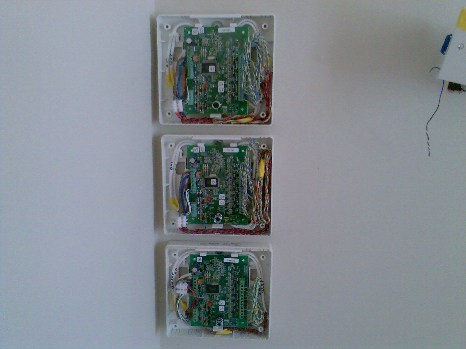

antinode Posted August 19, 2007 Share Posted August 19, 2007 I tend to twist a bit of wire around my twisted pairs. Helps keep them bundled together and easy to undo/replace if needed. In true Blue Peter fashion, here's one I made earlier: Trade Member Link to comment https://www.thesecurityinstaller.co.uk/community/topic/20327-i-wish-i-was-as-good-as-a-national/page/3/#findComment-175678 Share on other sites More sharing options...
arfur mo Posted August 19, 2007 Share Posted August 19, 2007 I tend to twist a bit of wire around my twisted pairs. Helps keep them bundled together and easy to undo/replace if needed. In true Blue Peter fashion, here's one I made earlier: hi antinode, your work looks great a great example (and just as it should ), at the risk of being called 'piccy' i'd only point out a pet hate of mine which is to do with the way you connect the 'aux' power connections. if you were to take the thicker cables into the same side of the terminal block as the red/blacks, you can then twist everything together and use the termnation pressure to keep a good connecton and so reducing the risk of intermittent power connections considerably. i'd also use those terminal blocks with the protection plates in (i know them as french connectors) to stop the strands being cut by the terminal screws. i'll probably be flamed now by all and sundry but i do intend as good advice, many service engineers will 'miss' a false alarm caused by such intermittent connections, especially in those early hours calls and change what was a perfectly good detector. regs alan If you think education is difficult, try being stupid!!!! Link to comment https://www.thesecurityinstaller.co.uk/community/topic/20327-i-wish-i-was-as-good-as-a-national/page/3/#findComment-175681 Share on other sites More sharing options...

antinode Posted August 19, 2007 Share Posted August 19, 2007 Thanks for the tip arfur. Duly noted for next time. on a slighty different note, i have a gardtec 595 im trying to get chime on zone 1 , ive set chime as on but cant assign to zone 1 any help gratefully appreciated as ive lost me engineer manual Go into engineers, YES to program zones, NO until you get to zone attributes then press YES. Press YES until you get to "CH 1", press NO then enter zone number you want chime on and press YES. Make sure it's enabled in the user menu. Trade Member Link to comment https://www.thesecurityinstaller.co.uk/community/topic/20327-i-wish-i-was-as-good-as-a-national/page/3/#findComment-175684 Share on other sites More sharing options...
ScorpioInstallations Posted August 19, 2007 Author Share Posted August 19, 2007 I tend to twist a bit of wire around my twisted pairs. Helps keep them bundled together and easy to undo/replace if needed. In true Blue Peter fashion, here's one I made earlier: First let me say fantastic! always nice to see Only thing that I would pick up on, Pet Hate, is that you have used insulation tape on your data's and on some cables and there is nothing worse than going back to a job in a few years when the tape has degraded and left sticky :!: all over the cables Never Teach Your Apprentice Everything You Know Link to comment https://www.thesecurityinstaller.co.uk/community/topic/20327-i-wish-i-was-as-good-as-a-national/page/3/#findComment-175700 Share on other sites More sharing options...
