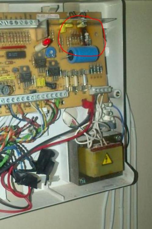

  1. Long gone are the days of identifying components and replacing them. Cost of new panel versus cost of labour time, price of a new panel wins hands down every time. I would still check the keypad cables first though, there is nothing worse than replacing a system only to find that the new panel has the same fault as the old one
  2. It probably is buggered, try the rkp on a short wire direct into the panel and see, It is hard to say based on what you have said, but it has to be over ten years old they stopped making them 10 years ago, theyre no longer supported, I would have replaced it already.
  3. No if the data is down, if you power up the rkp without data it just lights up
  4. Sounds like its beyond repair, lots of things it could be try wiring one of the keypads staight into the panel diss any existing keypad wires. If this works then you have a problem with one of the cables to the rkps. If it doesnt fix it then change the panel
