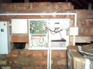

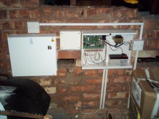

antinode Posted June 1, 2005 Share Posted June 1, 2005 My first ever install, and I will be ripping it out tommorow as we're moving. I'll do a few things differently next time though. I did'nt leave enough slack in the cables, so even though there's a decent amount there, there's not as much as I'd like. There are also a couple of unmarked cables, which should be fun identifying. Also, I kept adding bits to it, so it does look a bit messy. The PSU needs a grommet on the mains input, but apart from that, I'm a bit proud of it! Apologies for the mess on the floor too Trade Member Link to comment https://www.thesecurityinstaller.co.uk/community/topic/6349-for-old-times-sake/ Share on other sites More sharing options...
bellman Posted June 1, 2005 Share Posted June 1, 2005 Not too bad that fella, try to get some belden for the reinstall though. It'll save u grief in the long run as the Galaxy is fussy over shielding and earthing. Regards Bellman Service Engineer and all round nice bloke ) The views above are mine and NOT those of my employer. Link to comment https://www.thesecurityinstaller.co.uk/community/topic/6349-for-old-times-sake/#findComment-55553 Share on other sites More sharing options...
norman Posted June 1, 2005 Share Posted June 1, 2005 yeah, and tidy up yer mess ya scruffy git. Nothing is foolproof to a sufficiently talented fool. Link to comment https://www.thesecurityinstaller.co.uk/community/topic/6349-for-old-times-sake/#findComment-55565 Share on other sites More sharing options...

Brian c Posted June 2, 2005 Share Posted June 2, 2005 yeah, and tidy up yer mess ya scruffy git. 55565[/snapback] And you've left the lid off If you don't know......ask. Link to comment https://www.thesecurityinstaller.co.uk/community/topic/6349-for-old-times-sake/#findComment-55601 Share on other sites More sharing options...
breff Posted June 2, 2005 Share Posted June 2, 2005 And you could have put the 12v cable from the psu in trunking instead of just clipping it to the brickwork The opinions I express are mine and are usually correct! (Except when I'm wrong)(which I'm not) Link to comment https://www.thesecurityinstaller.co.uk/community/topic/6349-for-old-times-sake/#findComment-55631 Share on other sites More sharing options...
breff Posted June 2, 2005 Share Posted June 2, 2005 Good to see a monitored PSU though. The opinions I express are mine and are usually correct! (Except when I'm wrong)(which I'm not) Link to comment https://www.thesecurityinstaller.co.uk/community/topic/6349-for-old-times-sake/#findComment-55636 Share on other sites More sharing options...

antinode Posted June 2, 2005 Author Share Posted June 2, 2005 Thanks. Did'nt bother with trunking, as it's all gone now anyway. The PSU was only installed two weeks ago, so I thought it'd be alright for a couple of weeks. I connected the Trouble relay on the PSU across a zone, which triggers an output (LED) which I put in a surface patress/blanking plate on the landing, so I can see if it comes on. Trade Member Link to comment https://www.thesecurityinstaller.co.uk/community/topic/6349-for-old-times-sake/#findComment-55668 Share on other sites More sharing options...
