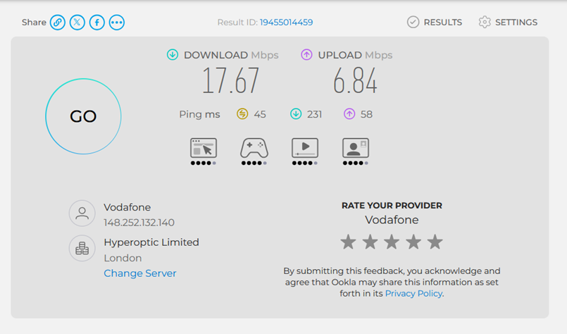

July 9Jul 9 comment_532230 This is my home internet over wifiWhen at home I post shite on the internet whilst watching shite on the internet some netflix but mostly youtubeThis is my clients home internet over wifi-I did him 3 x ruijie access points & ruijie poe routerMoans that call of duty is slow,Internet says , "a minimum of 100 Mbps download and 10 Mbps upload is recommended"I may be able to get the ISP to tinker but I think he's moaning for the sake of moaning Mr Veritas God Link to comment https://www.thesecurityinstaller.co.uk/community/topic/47525-internet-speed/ Share on other sites Share on LinkedIn Share on X Share on Facebook {lang="reddit_text" Share via email Share on Pinterest More sharing options... Share this post
July 10Jul 10 comment_532231 The ping is a litttle high, not a gamer so cant comment. Also the upload latency is high, google says it's "buffer bloat" and to check your routerMine, ping is usually around 6ms www.realsecurity.ie Link to comment https://www.thesecurityinstaller.co.uk/community/topic/47525-internet-speed/#findComment-532231 Share on other sites Share on LinkedIn Share on X Share on Facebook {lang="reddit_text" Share via email Share on Pinterest More sharing options... Share this post
July 10Jul 10 comment_532234 Bufferbloat would be my first thought.You can see the outbound ping is high underload and the "game" test is 4/5Could look at QoS stuff on the kit you fitted? Link to comment https://www.thesecurityinstaller.co.uk/community/topic/47525-internet-speed/#findComment-532234 Share on other sites Share on LinkedIn Share on X Share on Facebook {lang="reddit_text" Share via email Share on Pinterest More sharing options... Share this post
