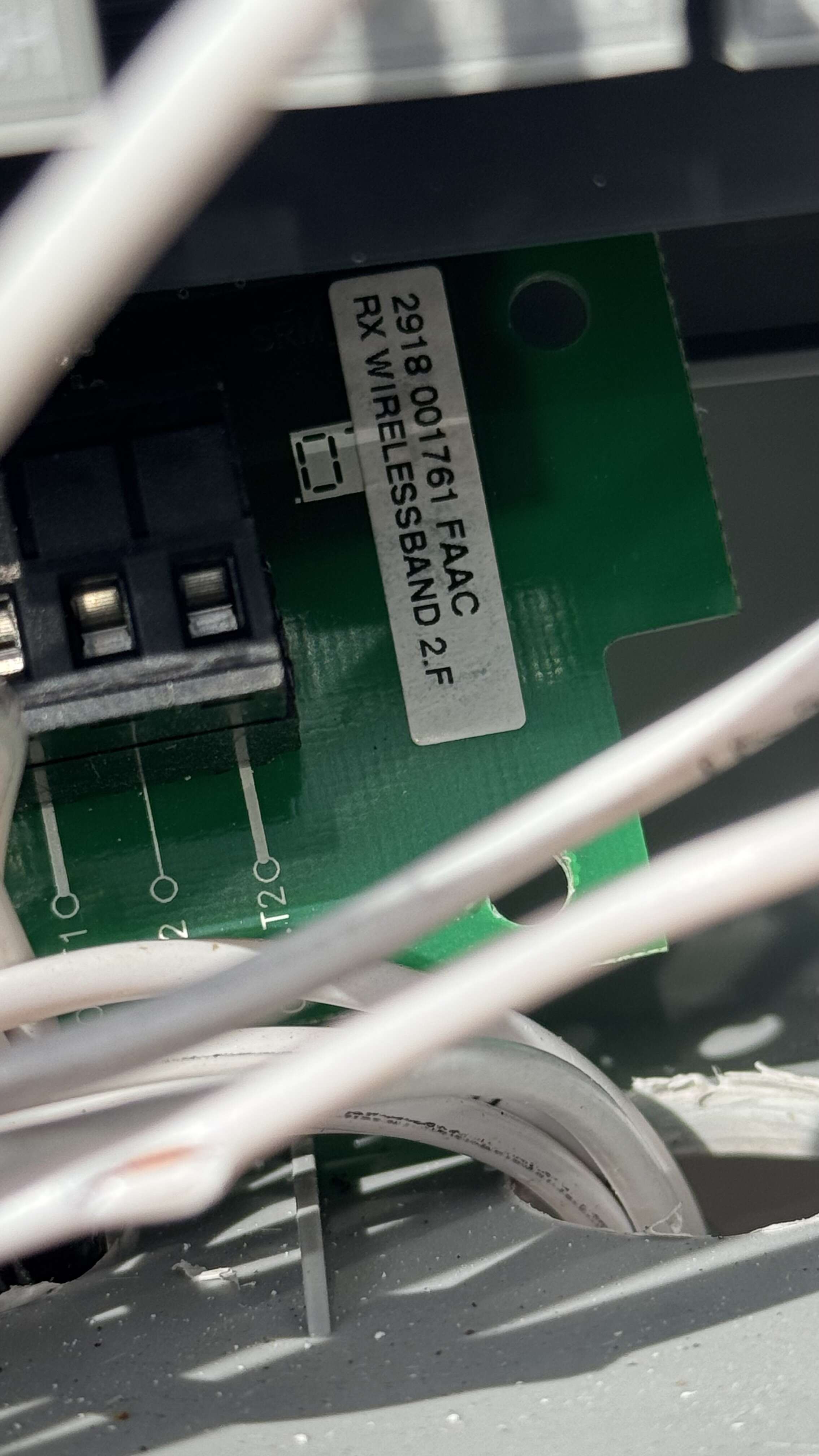

jmeader43 Posted March 11, 2025 Share Posted March 11, 2025 (edited) A site I look after is being overcharged each time they request a new remote for their electric gate The controller is a Nice MCA1 I have looked into the possibility of installing a Nice universal receiver that can support low cost remotes if there is such a thing It would also need to support 50+ remotes if possible for all staff and tenants I took some photos if anyone wants to have a look and let me know please. I am having trouble uploading them from my phone at the moment though Edited March 11, 2025 by jmeader43 Adding model number Link to comment https://www.thesecurityinstaller.co.uk/community/topic/47163-nice-branded-electric-gate-controller/ Share on other sites More sharing options...

james.wilson Posted March 11, 2025 Share Posted March 11, 2025 as far as i can see the nice rf reciever isnt fitted. Is it the faac module? Got a pic of a remote? securitywarehouse Security Supplies from Security Warehouse Trade Members please contact us for your TSI vetted trade discount. Link to comment https://www.thesecurityinstaller.co.uk/community/topic/47163-nice-branded-electric-gate-controller/#findComment-528350 Share on other sites More sharing options...
PeterJames Posted March 11, 2025 Share Posted March 11, 2025 Looks like there are two receivers FAAC one and the Nice onboard one. The Nice ones are rolling code so have to be programmed to the controller which means an engineer has to attend site plug in a keypad and program them. Not sure about the FAAC receiver could be rolling code or a standard receiver. The Nice rolling code fobs are not cheap but they are more secure than a standard fob as they are not easily cloned. Link to comment https://www.thesecurityinstaller.co.uk/community/topic/47163-nice-branded-electric-gate-controller/#findComment-528353 Share on other sites More sharing options...

james.wilson Posted March 11, 2025 Share Posted March 11, 2025 as i said above the nice rf module isnt fitted also the nice aerial isnt wired in securitywarehouse Security Supplies from Security Warehouse Trade Members please contact us for your TSI vetted trade discount. Link to comment https://www.thesecurityinstaller.co.uk/community/topic/47163-nice-branded-electric-gate-controller/#findComment-528356 Share on other sites More sharing options...
jmeader43 Posted March 11, 2025 Author Share Posted March 11, 2025 There are 2 aerials but it could be for each gate. I’ll take a photo of this on Friday and check if there is another gate controller or not thanks Link to comment https://www.thesecurityinstaller.co.uk/community/topic/47163-nice-branded-electric-gate-controller/#findComment-528357 Share on other sites More sharing options...

james.wilson Posted March 12, 2025 Share Posted March 12, 2025 the nice rf module would be plugged in here. As i should it isnt so im assuming your not use nice rf remotes 1 securitywarehouse Security Supplies from Security Warehouse Trade Members please contact us for your TSI vetted trade discount. Link to comment https://www.thesecurityinstaller.co.uk/community/topic/47163-nice-branded-electric-gate-controller/#findComment-528373 Share on other sites More sharing options...
