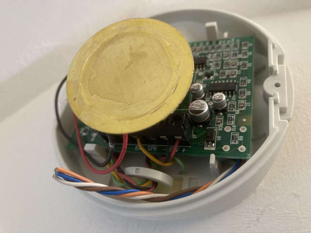

    Agreed bet it's a horrible sound bomb type thing connected to an output programmed as open closed rather than bell

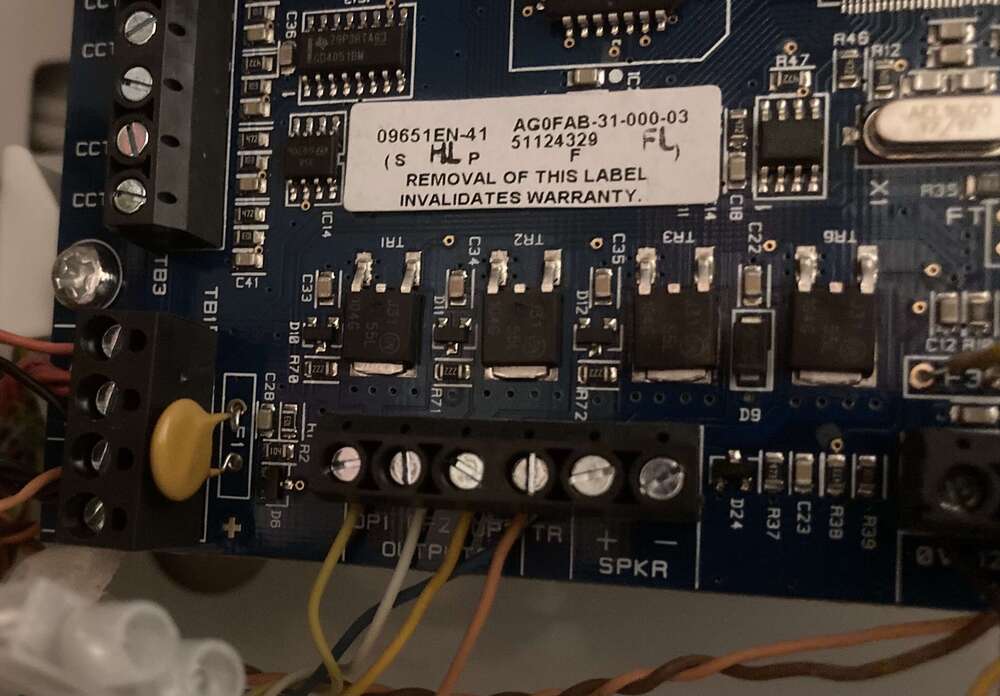

Check how the internal sounder is wired ? What connections is it going to?
This is the block for the outputs, I assume some are the internal, others the external sounder.
OP1, OP2, OP3 and TR left to right.
Edited by Dashnine
