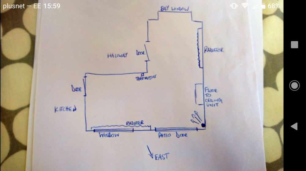

bennynoneck Posted April 26, 2020 Author Share Posted April 26, 2020 Hi all. Many thanks. I believe it was kit 2: https://texe.com/uk/products/series/wireless-kits/premier-elite-series/ So just a standard pir. I have another in the hallway and another in the kitchen and a wired one upstairs and a wired dt in garage. And a contact on the front door. I hope you can see the basic pic of my layout. Pir is in bottom right corner. I doesn't point to anything that moves. We have no pet. It does point to a wireless thermostat which on the wall opposite to the window if that helps. Im thinking of putting it in the opposite corner next to the window but then that's near a radiator which I guess is no good. And if I have it by the bay window it will be looking back at the windows and patio doors. These pour through light in the morning (although not at 4am in the morning lol). It is secure to the wall. It's about 3 inches from the corner so is secured on one side. I just used the same location as the previous pir which was put in by a company before I moved in. Cheers again. Quote Link to comment Share on other sites More sharing options...
PeterJames Posted April 26, 2020 Share Posted April 26, 2020 Looks the best location fo both rooms if its wireless you could swap it with another detector if the fault follows the detector then replace it, if the fault reoccurs in the lounge then its something environmental that your missing, I see nothing in that plan (unless you missed out some helium balloons from a recent party) that would cause fa's 1 Quote Link to comment Share on other sites More sharing options...

sixwheeledbeast Posted April 26, 2020 Share Posted April 26, 2020 Yer I wouldn't use any of the wireless kits apart from 0005 on the odd occasion it has most of what I need. Agree with above, looks like the most sensible position, I'd swap it with one from another room for now. If the fault reoccurs in the same room swap for a quad or possibly DT. Quote Link to comment Share on other sites More sharing options...

sixwheeledbeast Posted April 26, 2020 Share Posted April 26, 2020 You never know there maybe wireless interference but you have to start somewhere and you have no evidence of that. PIR's cannot detect through solid objects whereas the microwave part of a DT can. Your looking for something that could cause a sudden change in temperature of >5C within the 90 viewing angle of the passive. Quote Link to comment Share on other sites More sharing options...
