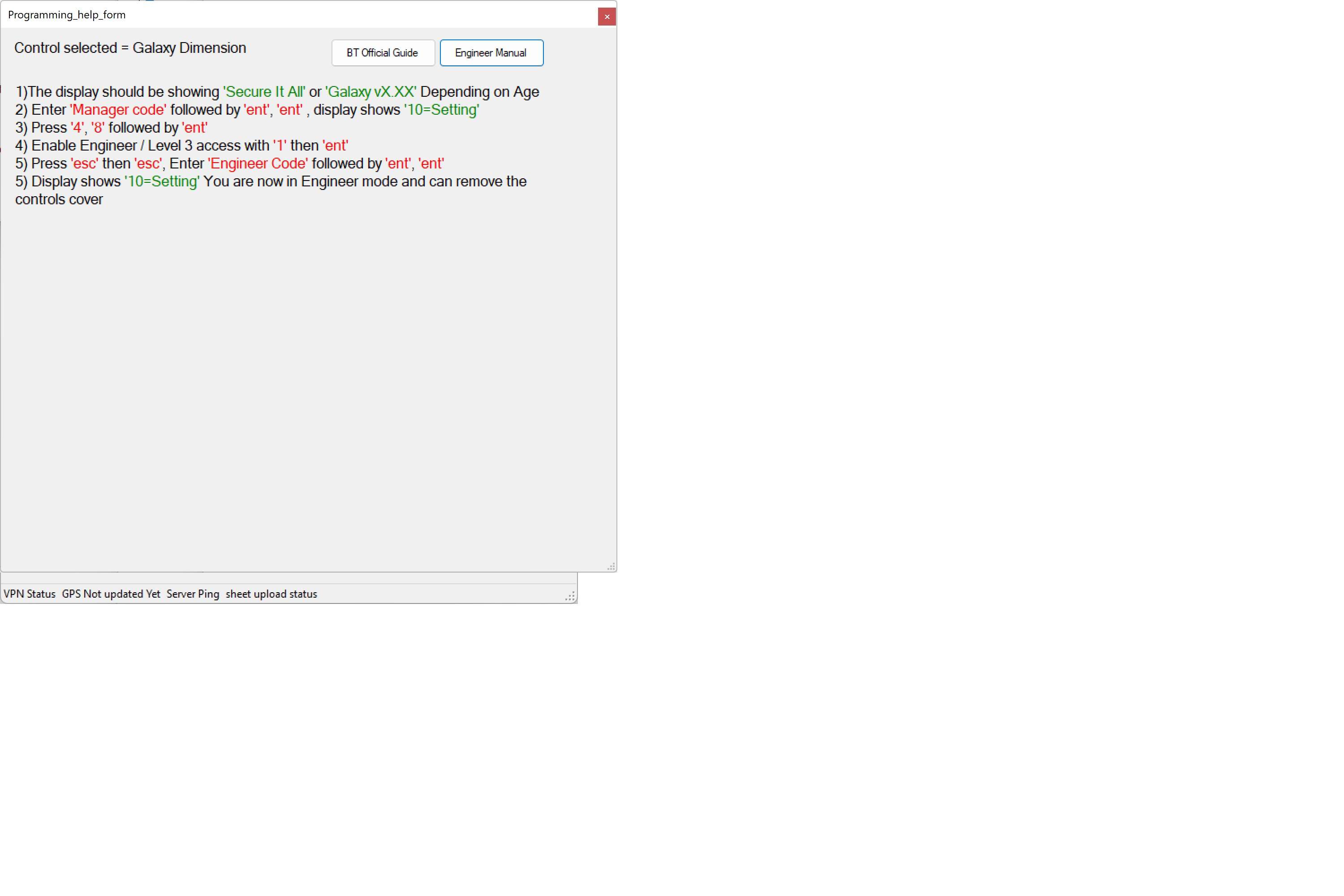

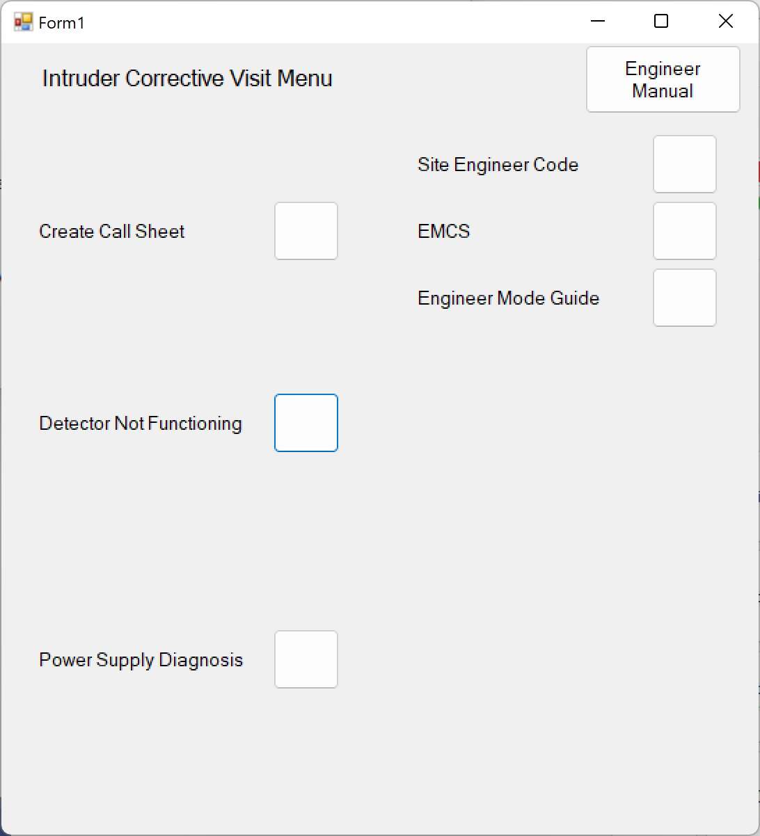

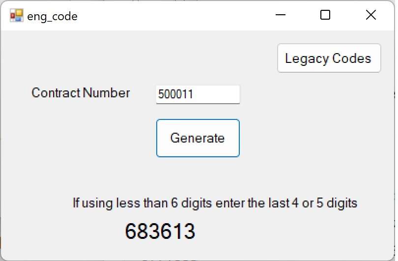

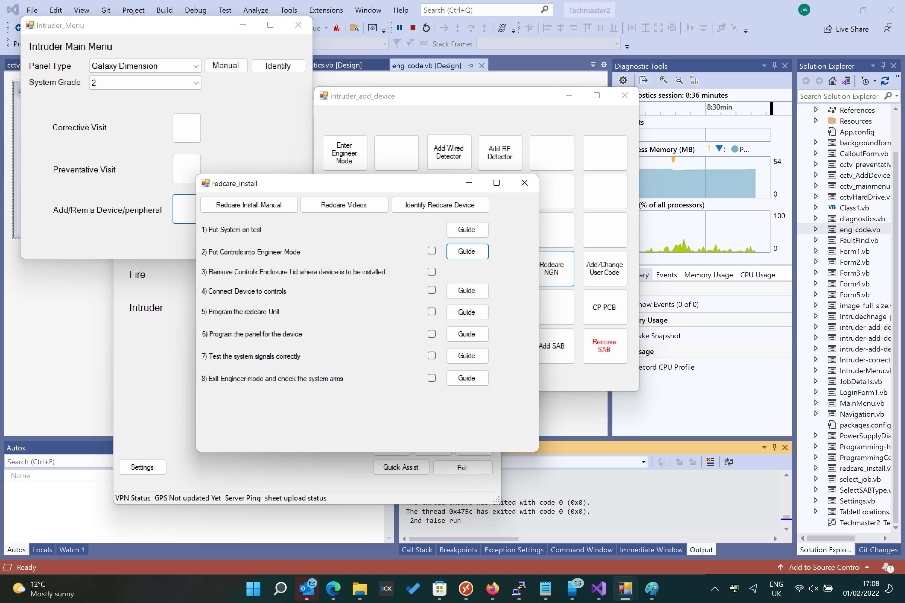

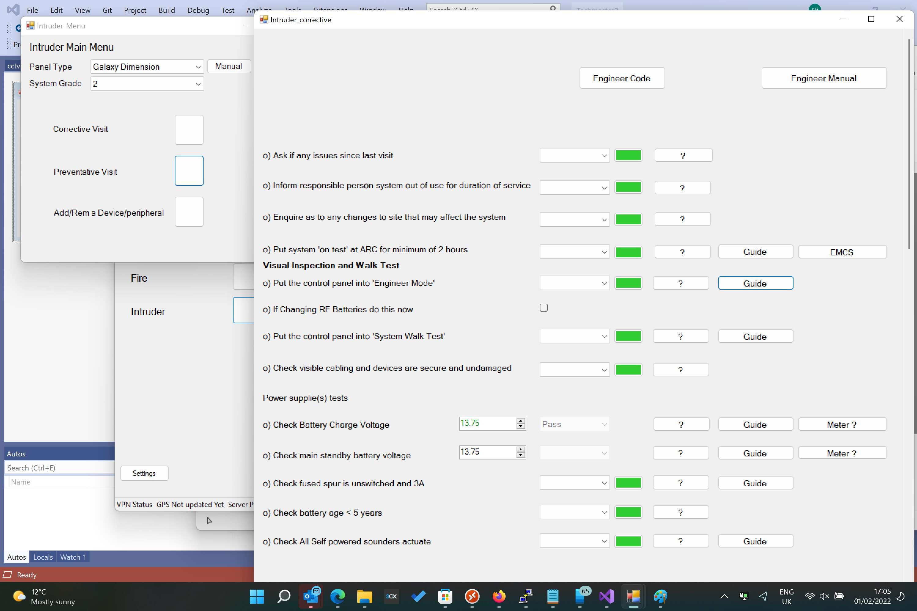

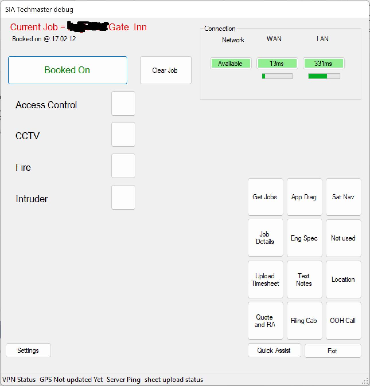

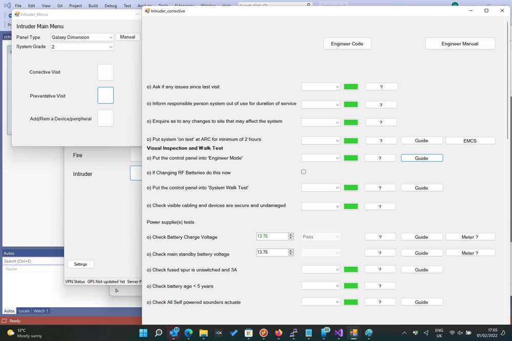

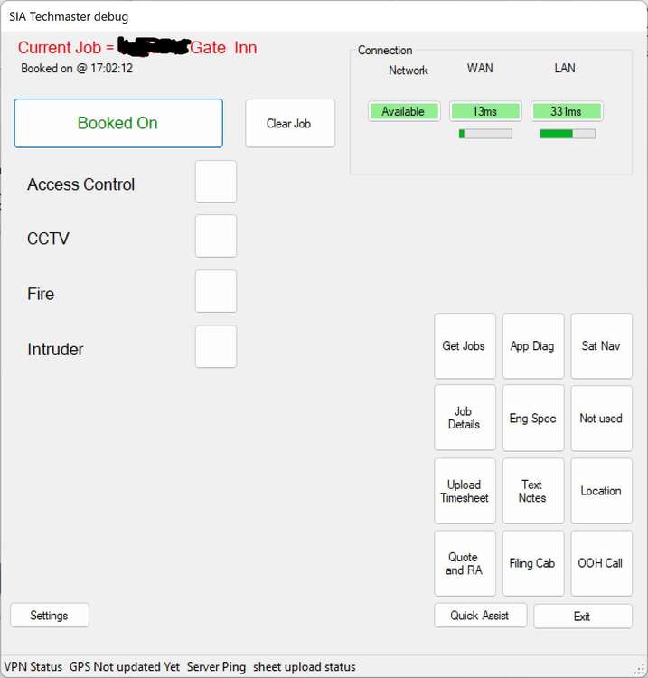

Ive done one that uses tablets linked to our DB, does the jobsheets (as pdf) uploads them to the db but need to be closed off by the office. Also tracks the tablets and stores location on job book on and book off. Automatically generates the time sheets. Has step by step guides on each mainstream task (this is an ongoing process) which gives menu access based on the panel type, dvr etc.
Still very much a work in progress but has become the training system and a comfort blanket. Has video guides as well but that is a bigger job for each one. Supports all our panels in use now.
Stores no data at all on device and communicates via open vpn with certificates.
Obviously the device can be locked out from the network if control lost etc.

I would have thought you would have opted for something like Pocket PC Creations and linked this back to your Dbase, all the maths, work flows etc are pretty easy albeit time consuming and it’s cheap.
Moving forward we have opted for PDA to be a user sorted via privileges.

looked at it for pocket pc's etc back in the day, now i can use full blown windows in the field its a no brainer. Surface Go's with lte mean im not limited to a mobile os, Also gives me remote assist on anything with a local connection. I can code for windows using visual studio granted i have a dev licence but looking at my limited skills i dont need it
As a side note the link between isnt direct, i wasnt brave enough. I use a combination of mysql (migrating to maria) and smb files. Totally keeping nothing on device, whilst the device has value outside of work, it wont have any work on it.
that is not the case for a lot of other systems
Id ask how do you know what the data share is public vs private vs proper vpn when you dont control that data?
I accept there is an argument when you develop your own stuff it has limited exposure, but if no data is known to be stored on device then its same. All these apps how much customer data is stored?
