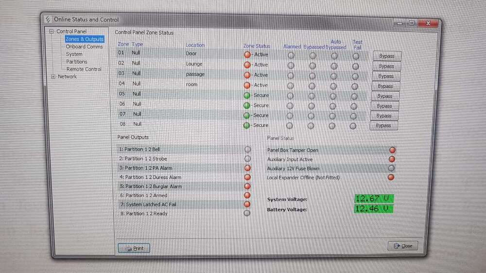

No matter what I set the zone config to, it shows active. So.. thinking after all this, something is broken?

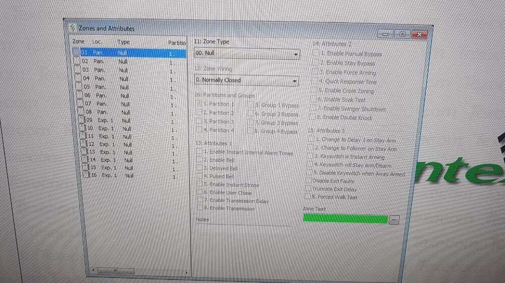

Turns out when they were all clear, they were all set to Null zone type, out of all the zone types and wiring, unless set to "N/O" it shows active. :(
Nope, constant "active", even if I clear faults/disarm. First 4 zones (the only zones this PCB has) are all redlining.
It would be pretty rare to have a duff panel, if your going to blow something you would likely only break one circuit. having all the circuits do the same makes me still think a programming option.
As I said I know Texe stuff pretty well but we rarely see international series over here, so I couldn't point you to the exact programming option from if that is what the issue is.
My advice for testing panels zones would be to remove ALL other wiring (to remove possibility of a ground loop) and only use short pieces of wire and/or resistors to test your circuits. I imagine you need to be in walk test/zone status or some other mode that would trigger if a zone where activated.

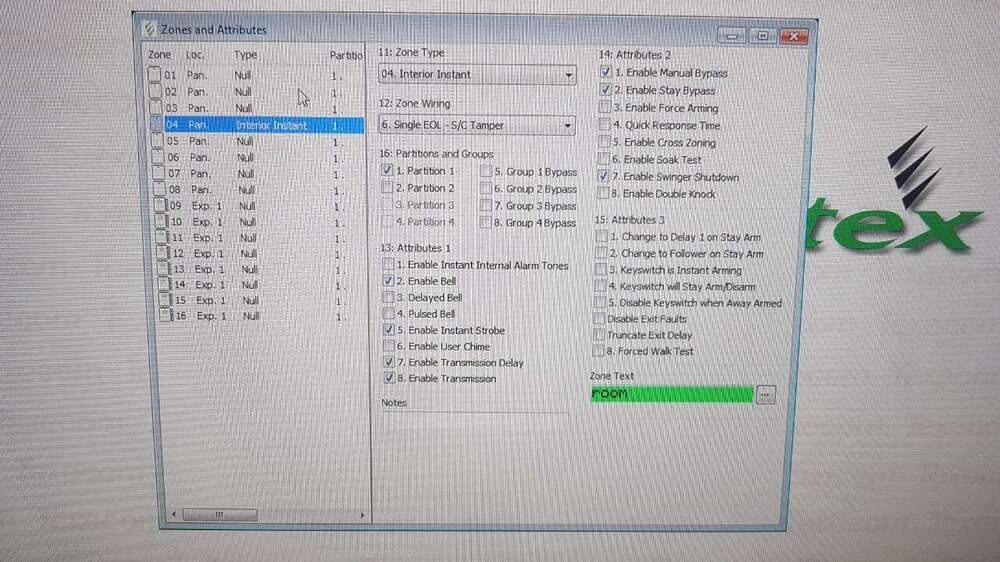

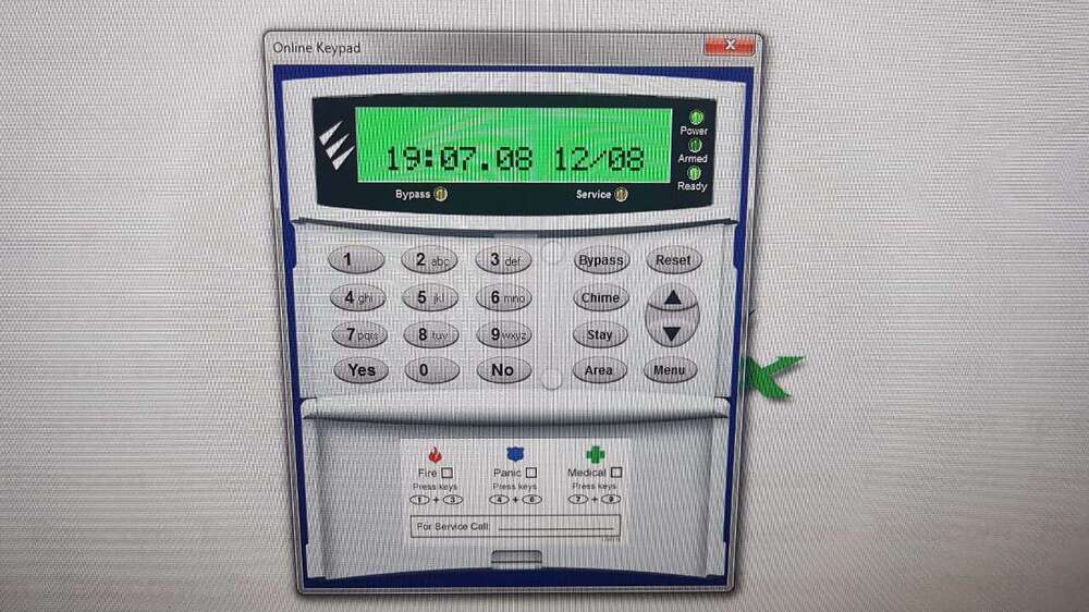

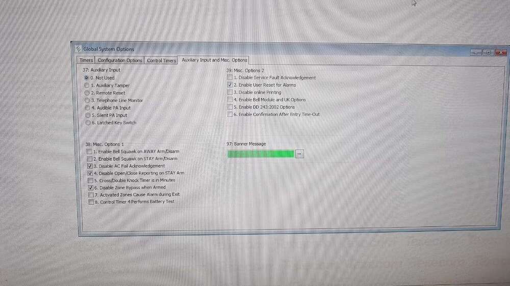

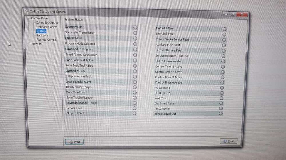

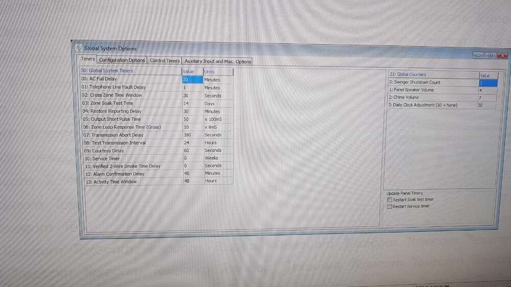

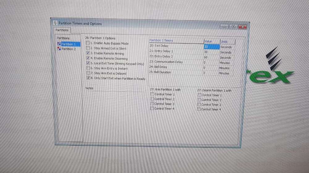

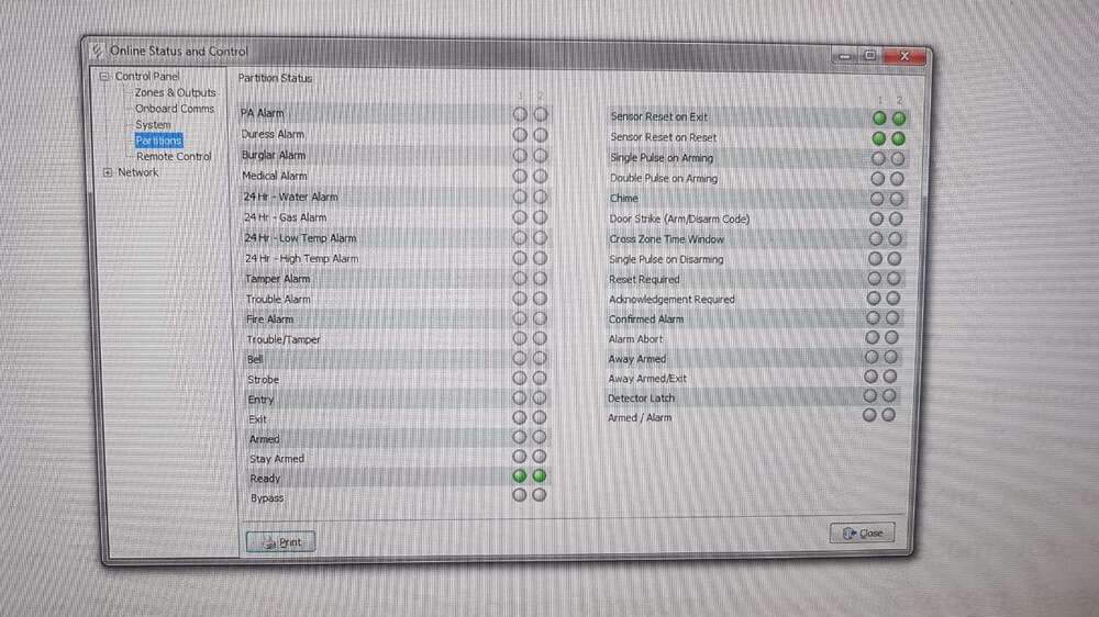

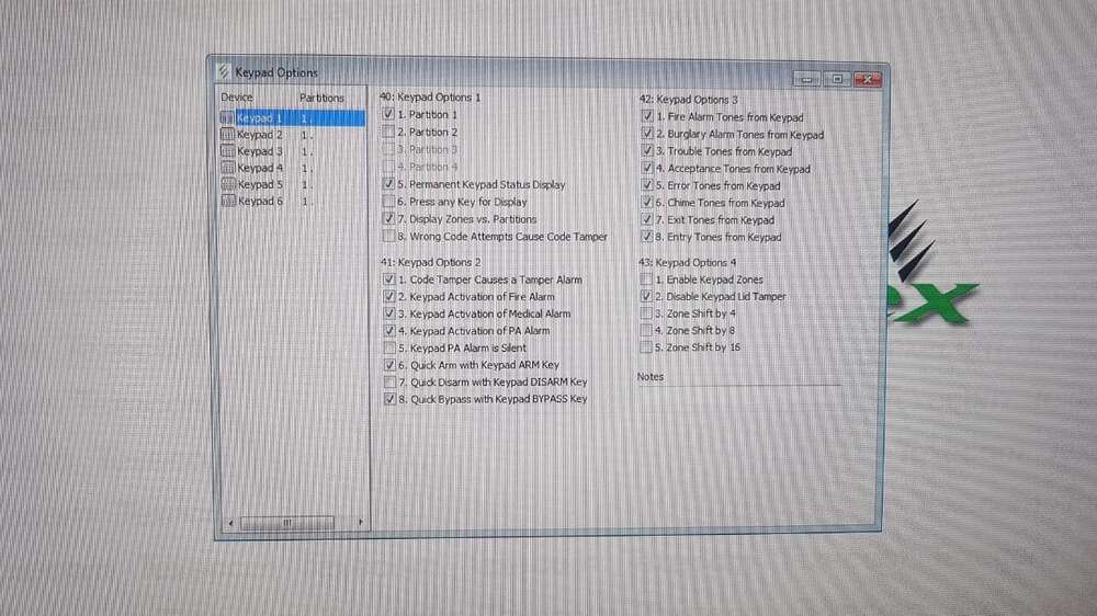

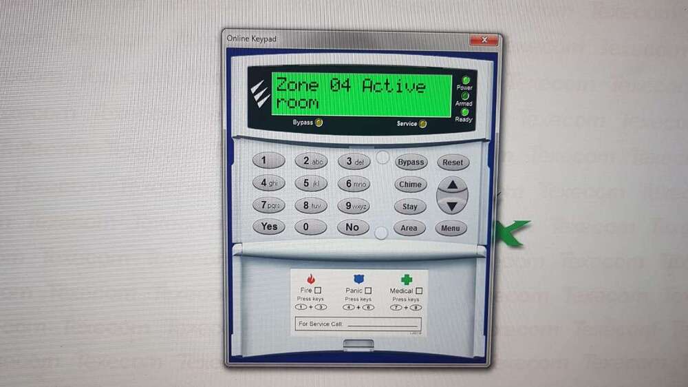

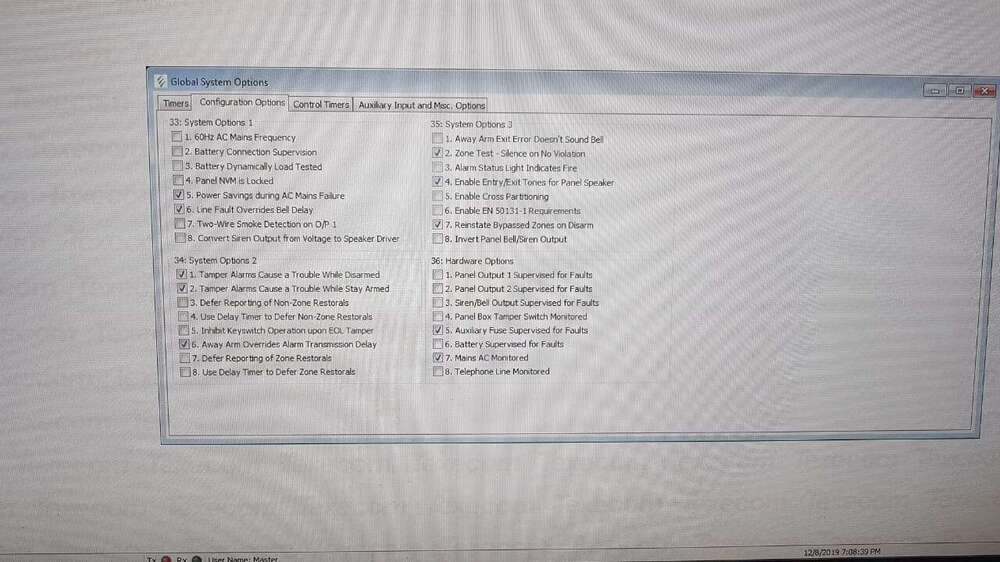

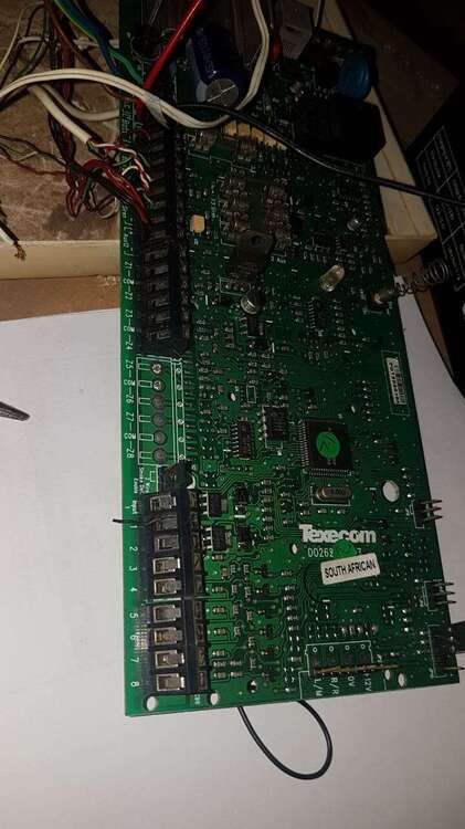

Ok let's start from the top. As of typing this I have removed all wiring except siren, remote, power and AUX power to the sensors. all sensor signal wires are removed. NO jumpers/resistors in yet. the terminals are empty. The settings for the zones are all nulled as a starting point. Here's pics of everything so far:

Edited by Shadrack
added 1 more pic of the PCB
Yeah, I set null since nothing is plugged in, now, with nothing plugged in, I changed to 04 Interior Instant with zone wiring Normally Open. shows no fault. so open circuit. which is correct. as there is no jumper/resistor. NOW changing to Single EOL - S/C Tamper, now shows zone 4 active. Gonna go install a jumper/dupont cable for Zone 4 now.
