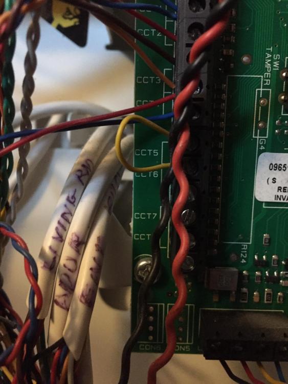

Whats on Zone 8? It's likely unrelated to the bellbox being a Zone
It says "technical" on instruction manual. only 1-4 zones are used.
Technical (TC) (Key in 08). Use this zone type when you want to monitor equipment, for example a freezer, without raising a full alarm. If a technical alarm zone is activated while the system is set, the system makes no audible alarm. However, when a user unsets the system the keypad indicates a fault.If a technical alarm zone is activated while the system is unset then the system starts a pulsed tone from the keypad. If programmed, the control unit also starts communication. When a user enters a valid code the keypad stops the tone and displays the zone.
Link it or make it used or spare

Just to clarify, I'm really not used to this, I'm a wood butcher by trade haha.
Link CCT7-CCT8, the same as CCT5-CCT6?
4 minutes ago, sixwheeledbeast said:
Just link them all like the white lines on the PCB
Thanks so much! Will do this, obviously turning everything off first.

1301167384_WhatsAppImage2019-01-19at13_56_27.thumb.jpeg.7b2d1b3ce753f850030ccd272ea7c7bc.jpeg
Now the alarm has frozen? It doesn't seem to be responsive, I've taken all my links out, and placed existing back in, battery off, kick started and same issue?
I really appreciate your help.
Coms to keypad might be missing check connections to keypad.both ways
You have only one keypad yes?
PERFECT!! We're sorted.
