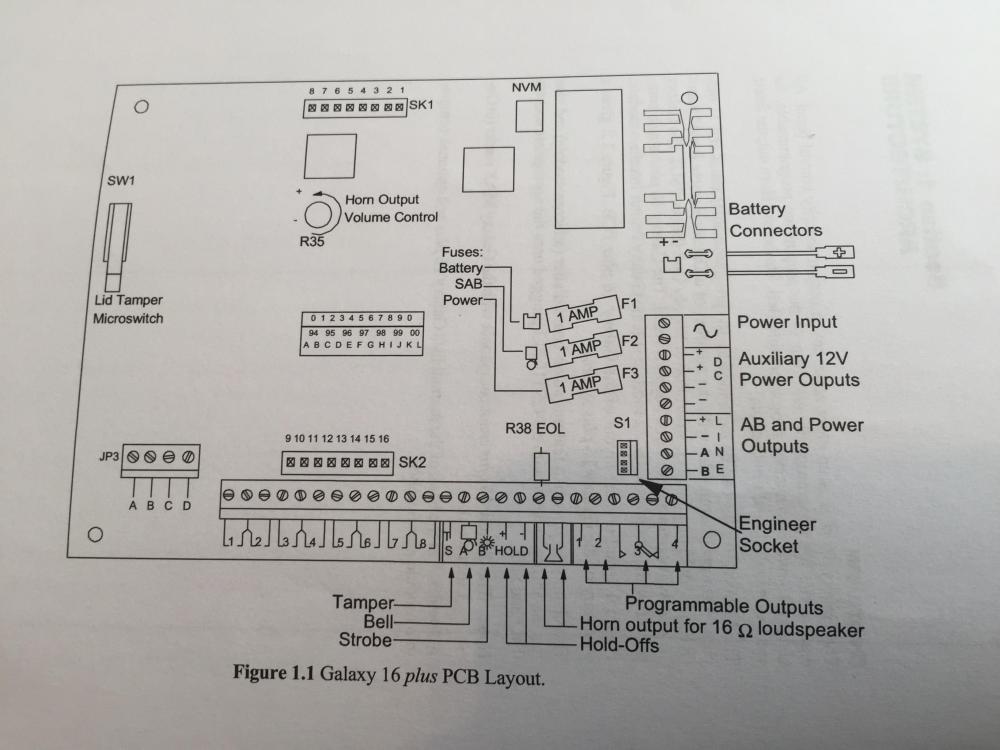

I haven't programmed the digi side as I'm not sure what a digi side is but someone else may well have done. I have attached a photo of the control panel, which is digital, so I assume that could mean the digi side is programmed (and it wont message directly to a phone)?
If that's the case can I put software or an app on an ipad, which would receive the message?
As above you said you entered the phone number, that com device is not a dialler like a speech dialler so won't do what you want it to do
You will need to buy a stand alone dialler to connect to a trigger
