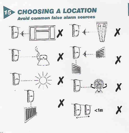

Guest mike2004 Posted October 26, 2004 Share Posted October 26, 2004 This is what the Reflex instructions say on the matter: I think in view of the general advice given, I'll try and angle the PIR slightly off from the window, although it will still face in that general direction. The house is well set back from the road, so headlights shouldn't be a problem, and the window is a bay one, so the PIR will only see one of the panes. Mike Link to comment https://www.thesecurityinstaller.co.uk/community/topic/4060-sitting-pirs/page/3/#findComment-29352 Share on other sites More sharing options...
